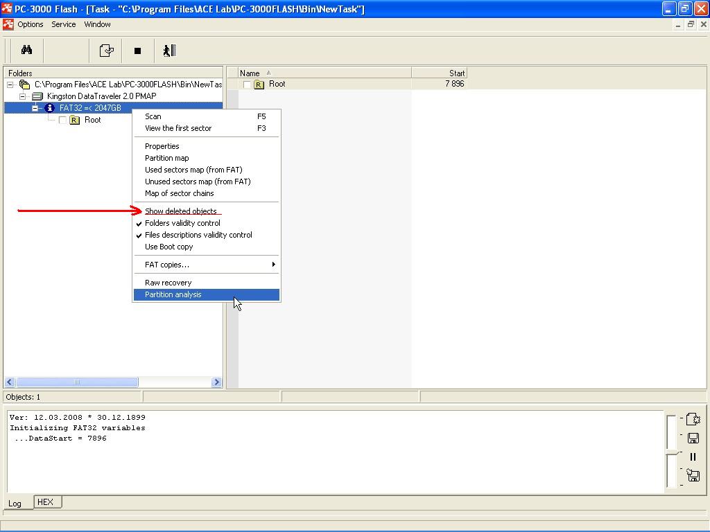

I tried this very easy to recover not only from usb flash memory but also from nay driver .... after trying this u will quite help full to any drive...

He-he :D
You've shown us just a little part of PC3K flash abilities.
It was just a deleted files recovery.
You no need to launch partition analysis, just click "show deleted objects"...Very easy and very quick.
Actually you also no need to search unadressed area and RAW data bacause this options are only for case in which is a damaged controller on its PCB.
"Location check for files" is also useless option in such case because you'll get only files which location is known in FS. It's like reverse action of RAW recovery.
