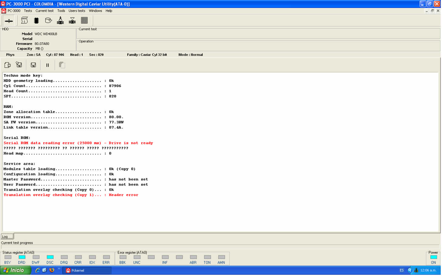

I have a WD800BB HDD with problem... i need your help, thank.

Does the drive sound normal?
(I.e. Spin up and calibrate.)
Or spin up, click and spin down?

The disk spin up, three times click and spin down..

Heads I bet...Try disabling one head at a time....

May be it has bad sectors on SA area. As to
your screen shot, SA FW has not been read.
Rewriting the bad modules or relocating the bad sectors may help.
SalvationData has SA modules relocation option for WD drives.
:idea: Before doing anything, use "head test" option of the PC-3K to be sure that
the problem is not bad head.

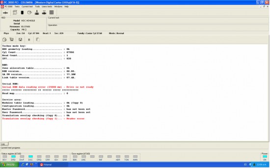

Hi Gurus,
CK was right. Disabled head 1 and I left only activates the 0, now the disc does not sound (clicks) and spin up normal.
Still it is not recognized totally.
I tested of head 0 and this good.
I did service area format and now it has access to the SA,
Result SA structure test:
the modules are well only in Copy (0) in Copy (1) not.
The cylinders from the -1 to the -19 are good the -20 bad.

D5: 1 : Dr : -10: 0: 174: 144:Yes :Error: Ok : 00 :/WRONG/ :..... :Selfscan test microprogram
D6: 0 : Dr : -1: 0: 318: 144:Yes : Ok : Ok : C0 :07-10-02:588G? :Selfscan test microprogram
D6: 1 : Dr : -10: 0: 318: 144:Yes :Error: Ok : 00 :/WRONG/ :..... :Selfscan test microprogram
C4: 0 : Dr : -1: 0: 514: 109:Yes : Ok : Ok : 30 :04-08-03:L.0KW :Calibrations module
C4: 1 : Dr : -10: 0: 514: 109:Yes :Error: Ok : 00 :/WRONG/ :..... :Calibrations module
C5: 0 : Dr : -1: 0: 623: 3:Yes : Ok : Ok : A2 :15-07-03:L.08? :Calibrations log (DCM)
C5: 1 : Dr : -10: 0: 623: 3:Yes :Error: Ok : 00 :/WRONG/ :..... :Calibrations log (DCM)
EF: 0 : Dr : -1: 0: 626: 72:Yes : Ok : Ok : 21 :04-08-03:58XXW :Selfscan test microprogram
EF: 1 : Dr : -10: 0: 626: 72:Yes :Error: Ok : 00 :/WRONG/ :..... :Selfscan test microprogram
E2: 0 : Dr : -1: 0: 698: 74:Yes : Ok : Ok : D3 :04-08-03:58XXW :Selfscan test microprogram
E2: 1 : Dr : -10: 0: 698: 74:Yes :Error: Ok : 00 :/WRONG/ :..... :Selfscan test microprogram
E4: 0 : Dr : -2: 0: 634: 50:Yes : Ok : Ok : E1 :04-08-03:58XXW :Selfscan test microprogram
E4: 1 : Dr : -11: 0: 634: 50:Yes :Error: Ok : 00 :/WRONG/ :..... :Selfscan test microprogram
E5: 0 : Dr : -2: 0: 684: 74:Yes : Ok : Ok : 45 :04-08-03:58XXW :Selfscan test microprogram
E5: 1 : Dr : -11: 0: 684: 74:Yes :Error: Ok : 00 :/WRONG/ :..... :Selfscan test microprogram
D9: 0 : Dr : -3: 0: 526: 74:Yes : Ok : Ok : 14 :04-08-03:58XXW :Selfscan test microprogram
D9: 1 : Dr : -12: 0: 526: 74:Yes :Error: Ok : 00 :/WRONG/ :..... :Selfscan test microprogram
E3: 0 : Dr : -3: 0: 600: 55:Yes : Ok : Ok : 6C :04-08-03:58XXW :Selfscan test microprogram
E3: 1 : Dr : -12: 0: 600: 55:Yes :Error: Ok : 00 :/WRONG/ :..... :Selfscan test microprogram
F3: 0 : Dr : -3: 0: 655: 52:Yes : Ok : Ok : 59 :04-08-03:58XXW :Selfscan test microprogram
F3: 1 : Dr : -12: 0: 655: 52:Yes :Error: Ok : 00 :/WRONG/ :..... :Selfscan test microprogram
E7: 0 : Dr : -3: 0: 707: 51:Yes : Ok : Ok : F7 :04-08-03:58XXW :Selfscan test microprogram
E7: 1 : Dr : -12: 0: 707: 51:Yes :Error: Ok : 00 :/WRONG/ :..... :Selfscan test microprogram
E9: 0 : Dr : -7: 0: 0: 94:Yes : Ok : Ok : 5D :04-08-03:58XXW :Selfscan test microprogram
E9: 1 : Dr : -16: 0: 0: 94:Yes :Error: Ok : 00 :/WRONG/ :..... :Selfscan test microprogram
ED: 0 : Dr : -7: 0: 94: 60:Yes : Ok : Ok : FC :04-08-03:58XXW :Selfscan test microprogram
ED: 1 : Dr : -16: 0: 94: 60:Yes :Error: Ok : 00 :/WRONG/ :..... :Selfscan test microprogram
F2: 0 : Dr : -7: 0: 154: 49:Yes : Ok : Ok : A9 :04-08-03:58XXW :Selfscan test microprogram
F2: 1 : Dr : -16: 0: 154: 49:Yes :Error: Ok : 00 :/WRONG/ :..... :Selfscan test microprogram
F4: 0 : Dr : -7: 0: 203: 74:Yes : Ok : Ok : 39 :04-08-03:58XXW :Selfscan test microprogram
F4: 1 : Dr : -16: 0: 203: 74:Yes :Error: Ok : 00 :/WRONG/ :..... :Selfscan test microprogram
F5: 0 : Dr : -7: 0: 277: 73:Yes : Ok : Ok : 9E :04-08-03:58XXW :Selfscan test microprogram
F5: 1 : Dr : -16: 0: 277: 73:Yes :Error: Ok : 00 :/WRONG/ :..... :Selfscan test microprogram
FD: 0 : Dr : -1: 0: 772: 5:Yes : Ok : Ok : 86 :04-08-03:`T0Q? :Selfscan log
FD: 1 : Dr : -10: 0: 772: 5:Yes :Error: Ok : 00 :/WRONG/ :..... :Selfscan log
FB: 0 : Dr : -7: 0: 350: 50:Yes : Ok : Ok : 06 :04-08-03:58XXW :Selfscan test microprogram
FB: 1 : Dr : -16: 0: 350: 50:Yes :Error: Ok : 00 :/WRONG/ :..... :Selfscan test microprogram
D3: 0 : Dr : -7: 0: 400: 68:Yes : Ok : Ok : 8E :04-08-03:58XXW :Selfscan test microprogram
D3: 1 : Dr : -16: 0: 400: 68:Yes :Error: Ok : 00 :/WRONG/ :..... :Selfscan test microprogram
D2: 0 : Dr : -7: 0: 468: 49:Yes : Ok : Ok : 94 :04-08-03:58XXW :Selfscan test microprogram
D2: 1 : Dr : -16: 0: 468: 49:Yes :Error: Ok : 00 :/WRONG/ :..... :Selfscan test microprogram
D7: 0 : Dr : -7: 0: 517: 54:Yes : Ok : Ok : BF :04-08-03:58XXW :Selfscan test microprogram
D7: 1 : Dr : -16: 0: 517: 54:Yes :Error: Ok : 00 :/WRONG/ :..... :Selfscan test microprogram
D8: 0 : Dr : -7: 0: 571: 49:Yes : Ok : Ok : 83 :04-08-03:58XXW :Selfscan test microprogram
D8: 1 : Dr : -16: 0: 571: 49:Yes :Error: Ok : 00 :/WRONG/ :..... :Selfscan test microprogram
DA: 0 : Dr : -7: 0: 620: 74:Yes : Ok : Ok : 49 :04-08-03:58XXW :Selfscan test microprogram
DA: 1 : Dr : -16: 0: 620: 74:Yes :Error: Ok : 00 :/WRONG/ :..... :Selfscan test microprogram
FA: 0 : Dr : -8: 0: 0: 72:Yes : Ok : Ok : D4 :04-08-03:58XXW :Selfscan test microprogram
FA: 1 : Dr : -17: 0: 0: 72:Yes :Error: Ok : 00 :/WRONG/ :..... :Selfscan test microprogram
C3: 0 : : -2: 0: 758: 37:Yes : Ok : Ok : BA :04-08-03:B.08W :
C3: 1 : : -11: 0: 758: 37:Yes :Error: Ok : 00 :/WRONG/ :..... :
41: 0 : : -1: 0: 0: 2:Yes : Ok : Ok : 9B :17-08-03:773RW :Modules directory
41: 1 : : -10: 0: 0: 2:Yes :Error: Ok : 00 :/WRONG/ :..... :Modules directory
Zone allocation table
Number of zones......................... : 2
# : Initial cylinder : Final cylinder : SPT
0 : -32 : -1 : 820
1 : 0 : 87 905 : 861
CONFIGURATION SECTOR (42)
SA Copy num Location Status
0 c: -2 H: 0 Ok
1 c:-11 H: 0 Ok
HDD ID
Model................................... : WDC WD800BB-75DKA0
Serial number........................... : WD-WMAHL3333858
Logical parameters...................... : Cyl : 155072 Head : 16 Sec : 63
Master-password
Set..................................... : No
User-password
Security level.......................... : High
Log DCM (C5)
0 c: -1 H: 0 Ok
1 c:-10 H: 0 Header
XEN Xenon 40
+ XEN codata L.08 ----- Drive Head DCM Codes -----+
| READ-RITE: F, 0, 7, Y ( zero offset head) |
| HEADWAY: D, 8, 9 ( zero-offset head) |
| ALPS: A ( zero-offset head) |
| ALPS: L, J, H, R (non-zero offset head) |
Avalable scripts
"B" - B9XENL.08
"_" - _9XENL.08
"V" - V9XENL.08
"T" - T9XENL.08
"A" - A9XENL.08
Log Version Info (4E)
0 c: -2 H: 0 Ok
1 c:-11 H: 0 Header
ROM version............................. : .......
Link table version...................... : ......
Disk FW version......................... : .......
P-List (43)
0 c: -2 H: 0 Ok
1 c:-11 H: 0 Header
Number of defects....................... : 684
G-List (44)
0 c: -2 H: 0 Ok
1 c:-11 H: 0 Header
Number of defects....................... : 83
That I need so that is recognized totally?
(excuse me for my english)
thank,
Carlos
