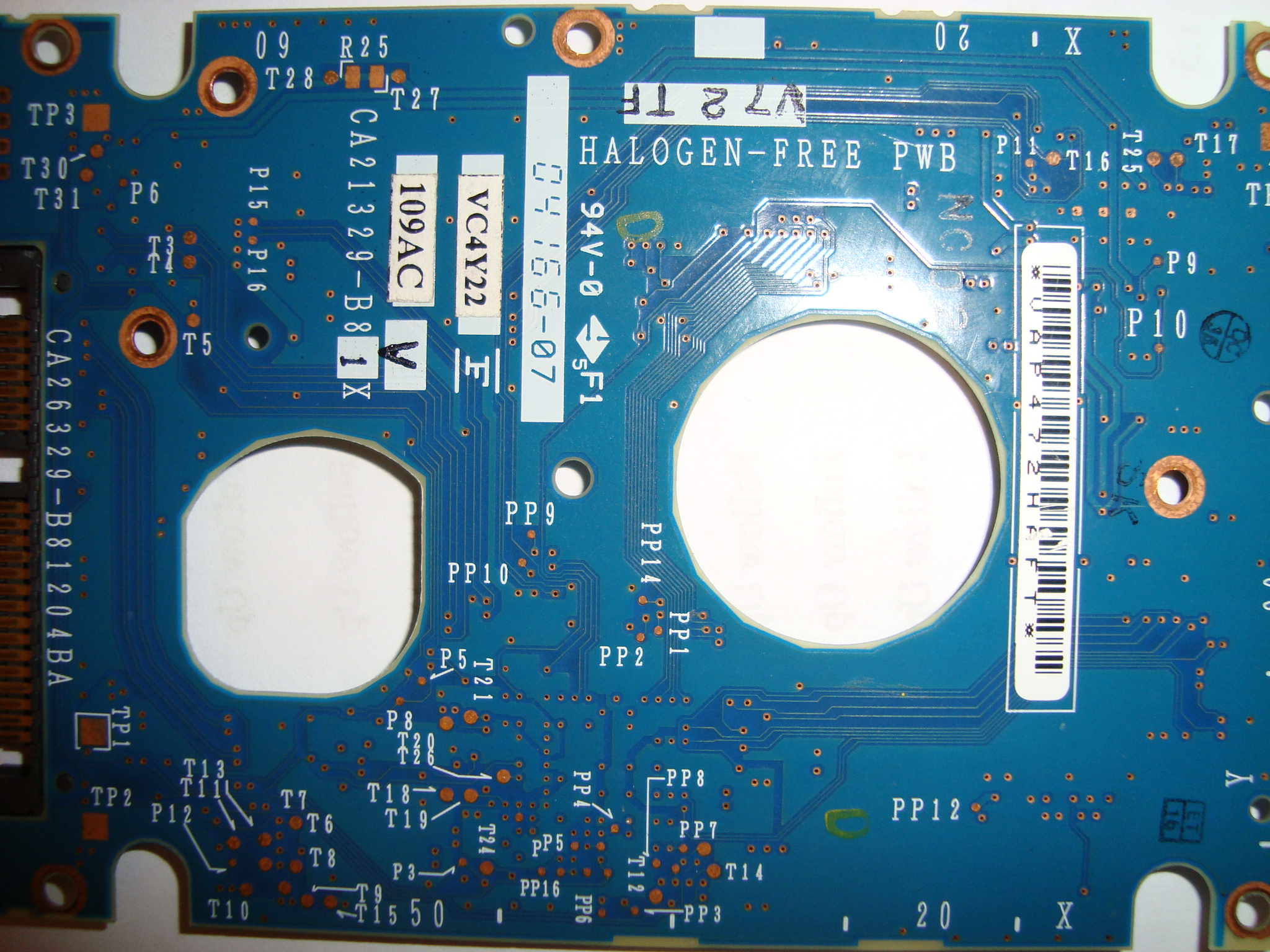

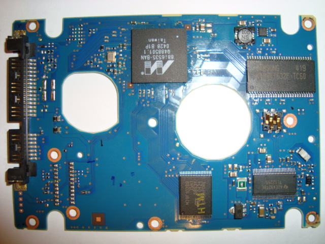

Drive does not spin. Replaced PCB and drive will spin up however I can not read the orginal pcb ROM. Which I/O channel can I short to enable kernel mode?

Short ROM chip data lines. It would help
Datasheet on this chip is easy to find
