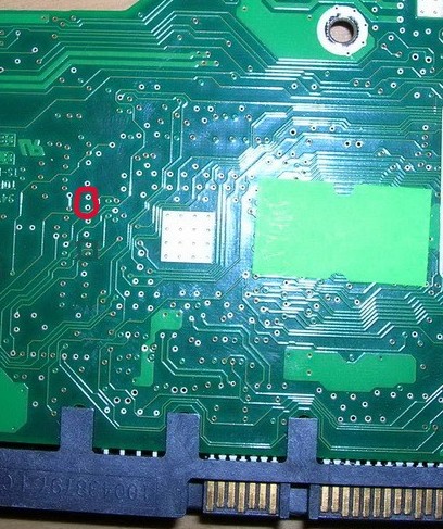

Hicky wrote:
Where is write channels located?...I have one ST3750330NS ES2 with HPG1 Firmware, and cant get past terminal lock..
I believe that's an error. You should probably be injecting your interference into the read channel.

 Post subject: Re: Seagate ST3250310NS Fw.HPG2 F3 family Lock Led problem
PostPosted: May 27th, 2016, 16:56
Posts: 210
Location: istanbul
thanks...
i recover all of my data via short pin.
PostPosted: May 31st, 2016, 11:53
Joined: June 6th, 2014, 11:19
Posts: 18
How to generate square wave in read/write channel
