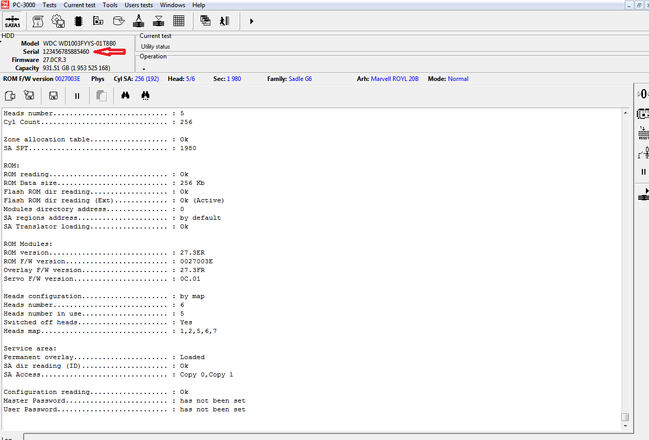

finally sorted out.
yes drive is fake, actually it is Sadle g6 family.
