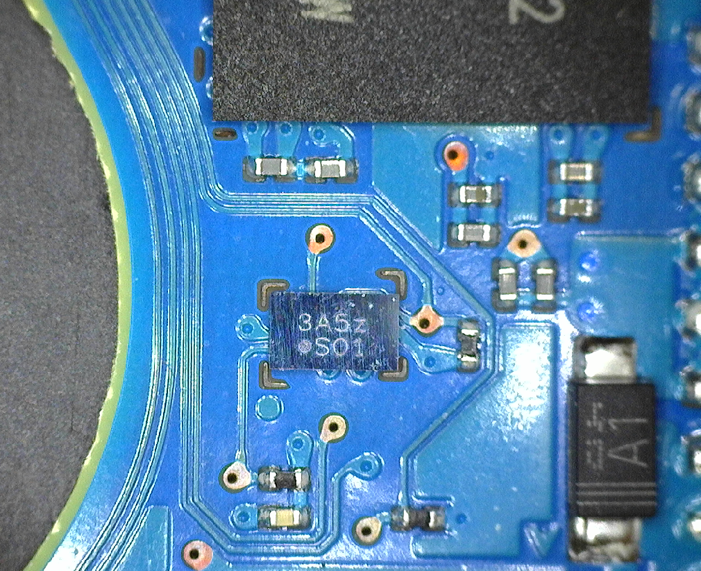

yes, if you don't get any output over serport, then there is likely some hw damage. Fix that first or move rom chip to a working pcb.
Yes there could be internal track or other electronic issue. Unfortunately manual chip reading is not possible so I have finally given up.
Thanks a lot.

how about moving the rom chip to a known good pcb?
Hi pepe
Unfortunately I can't remove ROM from 2.5" disk PCB (can only desolder TSOP type desktop roms) .
Actually I don't know which type of ROM chip this model has .

terminator2 wrote:
Hi pepe

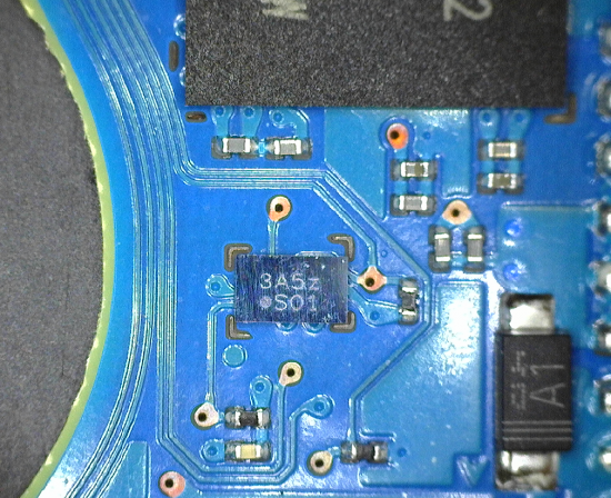

ROM chip is typical serial flash but in a WLCSP-8 P8 package. Tiny but possible to move or read via external programmer.

digisupport wrote:
terminator2 wrote:
Hi pepe
Thanks a lot :good: :-D
I will give it a try
