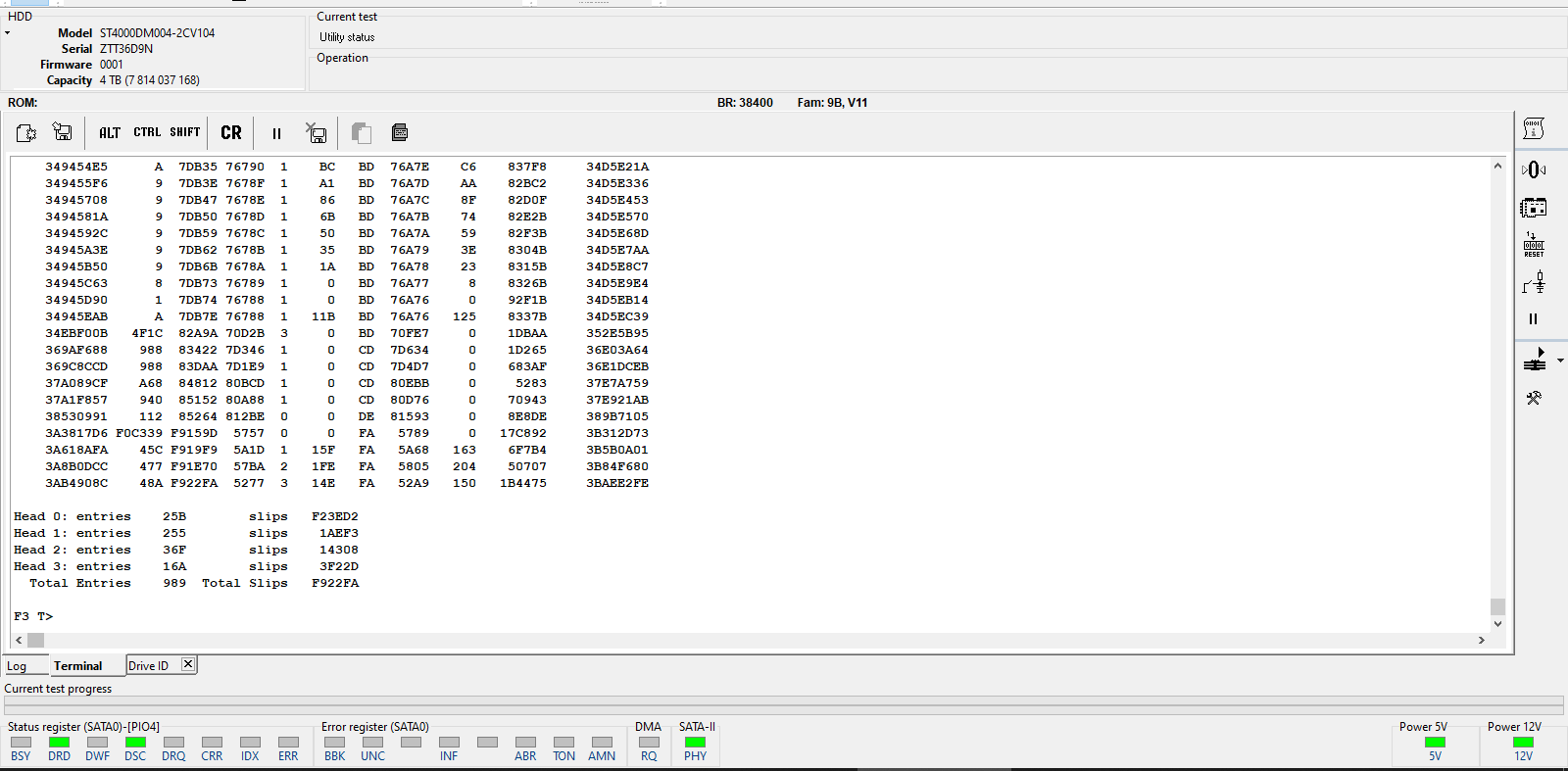

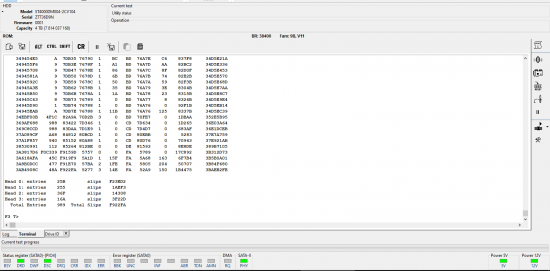

Good Morning fzabkar
I just can't believe how accurate diagnostic as well as remedy you have given based on few snapshots & terminal without actual checking.
Yes disk has given clear sector access , I could create head map without disk losing ready ness .
Head 2 seems to be healthy with aprox 10MB/sec read speed while other heads are slow , but I think following are the reasons -
1) I am not initializing disk properly - when to power on & unlock
2) Sys file 93 still unpatched.
3) Other files might need correction in order to smooth reading.
I am not going to do anything (not even smp patch) as I am not confident about my procedure. I am exporting acrep structure and based on customers selection trying to image only used sectors in order to further minimize any further mess.
Appreciate your technical expertise & help as with only few commands miraculously case is solved .At least it has saved my reputation as if I was about to return it as head weak /failed case.
Thank you for your help. :D :good:

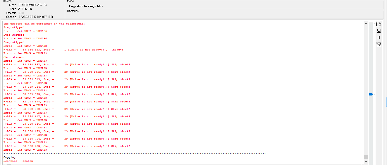

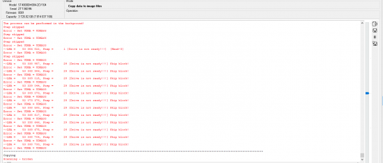

Update to this case
Disk has become smooth & I have been able to disable background scanning . But I think some head specific tuning is a must to recover data as disk becomes busy while scanning some heads (head 3) while for some heads it gives 15MB/sec speed.
May be due to defective zones are the reason.
Terminal output has changed now -

I have further observed that I cannot refresh utility status or disk is not initialized properly if system file reading is set to terminal , in indirect reading mode UA /SA ,FW can be read instantly. I think it has something to do with system file related issue & not necessarily head 3 ( head 3 is reading 15kb/sec now & disk loses readyness )
 Post subject: Re: Seagate 9B V11 family firmware diagnostics
PostPosted: May 31st, 2024, 4:57
Posts: 196
Head 3 is having varied reading speed ( 10kb/s to 20MB/s ) It might have become weak on particular zones .
PostPosted: June 2nd, 2024, 4:05
Posts: 196
Thanks to all of you particularly fzabkar & pepe I have concluded this case successfully.
I tried my best but was forced to disable Head 3 & recover data covered by other heads.
But it was great learning which will be useful for future . I would be happy to know whether Heads can be tuned on fw level in pc3k .
Thank you .

After issuing command , I got following output
I can't interpret what it means. But It has not improved reading. I think original issue could be in weak head 3 or defect list ,all I have done is work on sys file 93 I don't know how to repair other files and there role also.
May be in future cases I will go beyond sysfile 93 , I will have to learn about tec /sedu as well.
Thanks fzabkar it was all possible because of you only.
PostPosted: June 6th, 2024, 5:41
Posts: 4809
-slip list is ok if you can read other surfaces.
-H3 can read better at some areas, so it is likely not very weak.
-One thing remains: surface. if surface is damaged, you cannot expect thunder speed with whatever settings. However, if you set block size to 1, jump size to 1 and a bit higher timeouts, you can see the pattern of blacks and evaluate. Changing read retries in RWErrorRecovery group has no effect in most of the cases but there are other unofficial ways to limit retry count, speeding up the process a bit. But it won't be close to the speed of good areas in any case.
Of course, the data you get will have errors, so its value will be questionable anyway.
