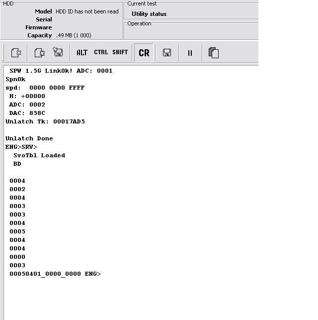

I have this Samsung drive that does not ID but reports ready The terminal looks normal when compared to another drive but when you try to read a sector or firmware it goes busy. Once it goes busy a hard reset puts it ready again. Drive does not make any clicking noises and spins up and stays on. I'm thinking pcb but not really sure. Attached is the terminal log. Any help would be apreciated. Thanks

Tried without the PATA adapter but bios does not pick up the drive. MHDD sees the port as BSY. RST makes it ready but goes back to BSY on EID command. Any attempts at reading the surface result in BSY.

Might be bad PCB then

networkpc3000 wrote:
hello,
i see some Samsung drive just spin up 4 second after down. and state busy.
That's SA problem

you need to find out exact problem and fix it
start problems search from A-List module

U can fix the SA using H/T test in these drives if u dont need data .
