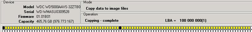

i Have other disk,
WD5000AAVS-00ZTB0
It detect by the pc3k UDMA my version is WD 4.02.
i can start the disk, i can see the module, but i can not edit,
when i try to copy with DE it give-me black.
Anyone have any ideia
ZeBong

Hi everybody thanks for trying help-me,
i Have this disk connected at ATA1 with the converter from PATA to SATA Disk from (ACE)
When i try to copy with DE i have two errors
ZeBong
ZeBong
" Россия еще раз"
 Post subject: Re: WD5000AAVS-00ZTB0 - Other Disk - Detect by the PC3kudma
PostPosted: November 6th, 2008, 12:03
Posts: 1421
Location: EUROPE
Is the utility still open when you attempt to access with DE?
Yes , First i have the utility open that read the ID off the disk,
Them open DE and dont select "HARDWARE RESET".
them DE open with the ID off the disk.
Them change to UDMA 33 and the error handling "1 " jump to "100"
ZeBong

Hi Doomer ,
do you know how can i rebuild the translator using a different family in the pc3k.
I am using the family pinnacle.
I can save the modules OK
ZeBong
ZeBong
" Россия еще раз"
PostPosted: November 6th, 2008, 13:32
Posts: 3598
Location: Chicago
You can use Tornado it's fine for recalc translator
PostPosted: November 7th, 2008, 8:53
Posts: 1421
Location: EUROPE
Hi Dommer,
Made the translator recontrution but did not work stay´s the same problem. :(
it appear some error int the sectores -91 ... -102 in red it can nor find them...
