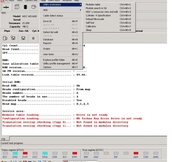

Hello
Have a disk with this when i connect :
It can not show-me the SA FW Version
Anyone have this error ?
Techno mode key:
HDD geometry loading.................... : Ok
Cyl Count............................... : 81004
Head Count.............................. : 4
SPT..................................... : 900
RAM:
Zone allocation table................... : Ok
ROM version............................. : 15.BE.
SA FW version........................... : ......
Link table version...................... : 05.66.
Serial ROM:
Read ROM................................ : Ok
Heads configuration..................... : From map
Heads number............................ : 6
The number of heads in use.............. : 4
Disabled heads.......................... : Yes
Head map................................ : 0,1,4,5
Service area:
Modules table loading................... : Drive is not ready
Configuration loading................... : WD Techno Key Error Drive is not ready
Translation overlay checking (Copy 0)... : Not found in modules directory
Translation overlay checking (Copy 1)... : Not found in modules directory

 Post subject: Re: WD1200JB-00FUA0
PostPosted: November 20th, 2008, 16:39
What about the modules?
Can you read/check them?
PostPosted: November 21st, 2008, 3:16
Joined: May 30th, 2005, 17:07
Posts: 550
Modules table NOT loaded!!! (module 41.rpm [~Dir.rpm])
At first Read (backup) all service tracks...
PostPosted: November 21st, 2008, 12:17
Posts: 550
At first Read (backup) all service tracks... (tracks not modules)
You can not read modules becouse modules table was NOT loaded!!!
Then read the manual... especially informations about module "ID=41h" and about "Utility extensions".

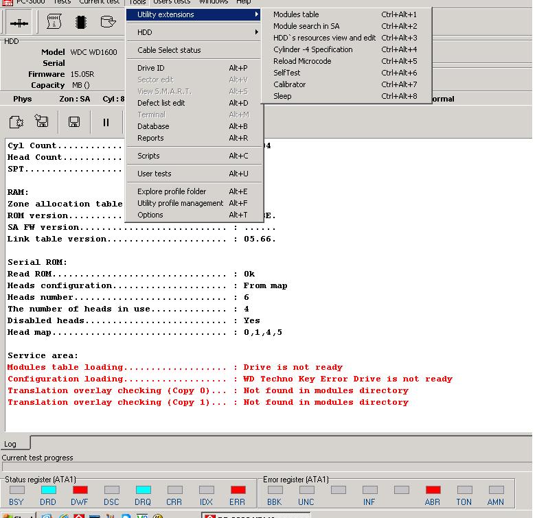

PostPosted: November 22nd, 2008, 11:51
Posts: 1421
Location: EUROPE
Thanks,
i go there and i dont see any backup off tracks.
ZeBong
ZeBong
" Россия еще раз"
PostPosted: November 22nd, 2008, 16:38
Posts: 2288
Location: In ur HDD !
Its in the test menu .
