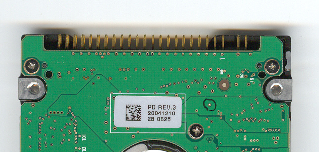

Samsung MAGMA REV. 03
Mikippp

Posts: 4850
these drives usually suffer from an error on the pcb that makes the drive unable to stabilize rotation and unable to park the heads, so they usually stick on the platter.
