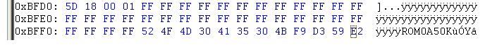

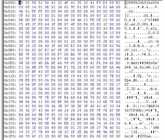

Hi doomer, i have been searching and i can not match yet the ROM CS with NVRAM.
i see the end off the ROM but no match that in the NVRAM
This example is for a AVVA, that is working.

 Post subject: Re: NV-RAM has unique adaptive data
PostPosted: December 29th, 2008, 21:44
Posts: 3593
Location: Chicago
it matches
F9D359E2
