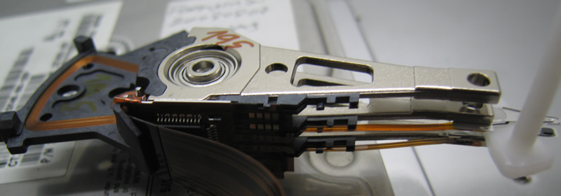

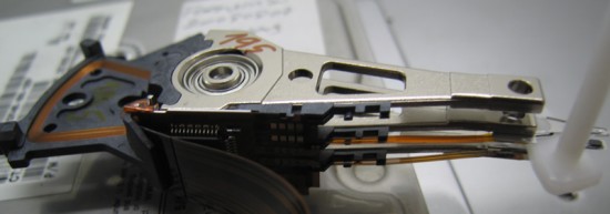

Hi NC
For info here is the old head that i change it.
ZeBong
ZeBong
" Россия еще раз"
 Post subject: Re: MAXTOR D540X-4K 40GB
PostPosted: January 15th, 2009, 10:11
Posts: 1466
Location: Europe, Hungary
Yes, i know, i have seen this a lot of times before. :D
I have made a lot of useless HE before i found the solution....
