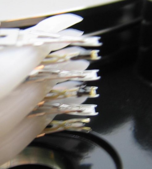

Have this error in terminal,
SPW 1.5G LinkOk!SpnOk
spd:  0000 0000 0000
ADC: 0000
DAC: 7F89
H: +00000
UF 2 BrkFsamErr
H: +00001
UF 2 BrkFsamErr
H: +00002
UF 2 BrkFsamErr
H: +00003
UF 2 BrkFsamErr
H: +00004
UF 2 BrkFsamErr
H: +00005
UF 2 BrkFsamErr
H: +00000
UF 2 BrkFsamErr
H: +00001
UF 2 BrkFsamErr
H: +00002
UF 2 BrkFsamErr
H: +00003
UF 2 BrkFsamErr
H: +00004
UF 2 BrkFsamErr
H: +00005
UF 2 BrkFsamErr
H: +00000
UF 2 BrkFsamErr
H: +00001
UF 2 BrkFsamErr
H: +00002
UF 2 BrkFsamErr
H: +00003
UF 2 BrkFsamErr
ENG>SRV>
Anyone can tell-me what is this ?
ZeBong
ZeBong
" Россия еще раз"
 Post subject: Re: HD400LJ
PostPosted: January 27th, 2009, 21:45
Posts: 4816
probably PCB or preamp problem.
Or the worst: all 6 heads are gone, and probably all 6 sides of the platters...
PostPosted: January 28th, 2009, 9:43
Posts: 1421
Location: EUROPE
pepe wrote:
Or the worst: all 6 heads are gone, and probably all 6 sides of the platters... pepe
Yes it´s the worst

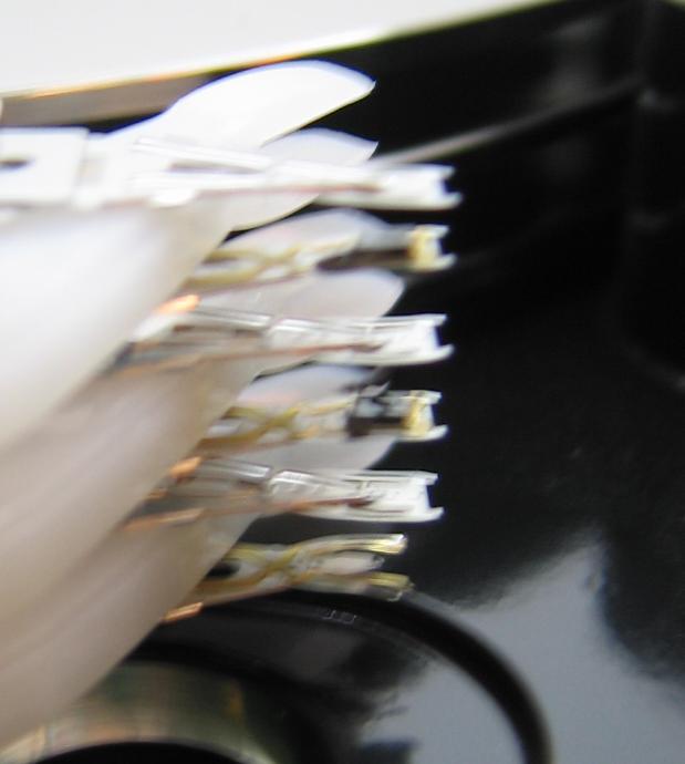

Head 0 , 1 missing
Head 2 and 3 stuck together.
Platter strikethrough, data gone here.
ZeBong
