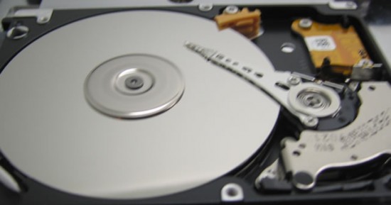

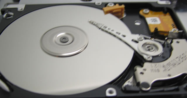

The PCB is the native one.
The drive is: ST9160821AS FW: 3.ALC
I open it and i notice that the heads stop at the middle.
Them it give this in terminal.
ERR Read App Code
F>
ZeBong
" Россия еще раз"
 Post subject: Re: SEAGATE MOMENTUS 5400.3 VENUS
PostPosted: January 29th, 2009, 16:35
Probably bad/weak heads then.
