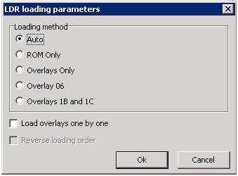

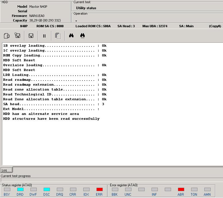

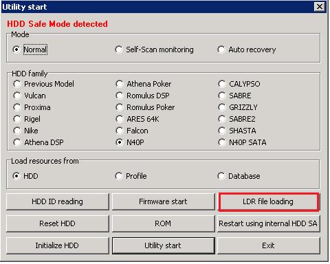

Put the disk in safe mode and enter the utility:

From the sound of the drive, it appears that heads and/or media are bad. However, you can try the following: after loader loads, you should run 1) HDD ID reading (which it looks like you did) to make sure firmware number changes to end in 0, and 2) Run Initialize HDD/Initialize all which, if proper loader has loaded, will correctly ID the drive. You should try several loaders to see if you can reach this stage. At that point you can try to read SA. If unsuccessful with loader then try hotswap with same model.
 Post subject: Re: How to fix a MAXTOR 6E040L0 40GB IDE
PostPosted: February 10th, 2009, 13:32
Posts: 1419
You have to check head condition and fix SA

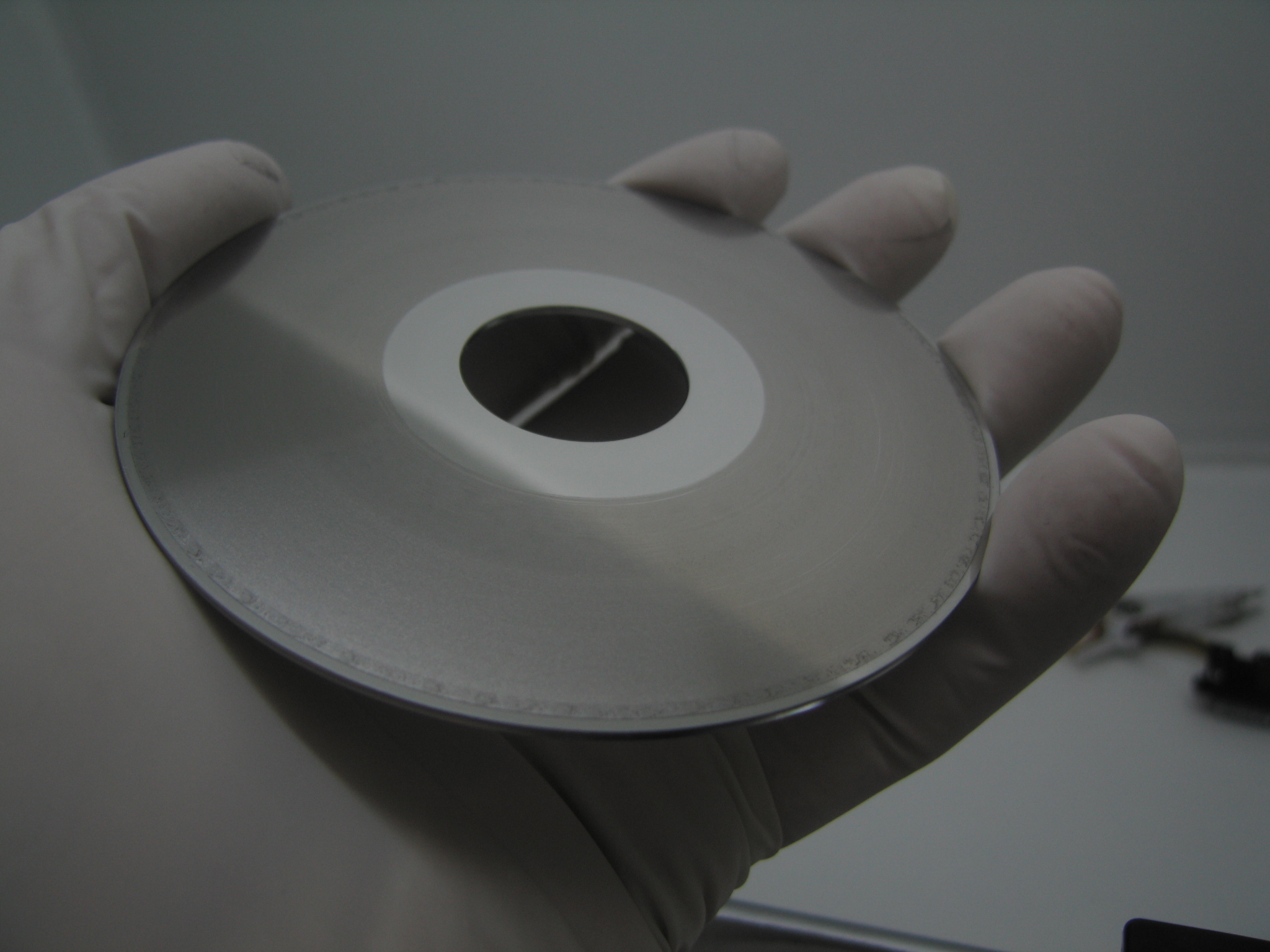

Afther open the disk, notice that the filter is very dirty, and the platte is like this:
ZeBong
" Россия еще раз"
PostPosted: March 6th, 2009, 17:07
Posts: 1466
Location: Europe, Hungary
Case closed.
PostPosted: May 26th, 2009, 9:11
Joined: May 26th, 2009, 9:07
Location: Bogota
How I Can to got this Utilitity load my LDR??
PostPosted: May 26th, 2009, 10:36
Posts: 1466
This is the PC3000 UDMA on the pic.
You need to buy it.
Janos
