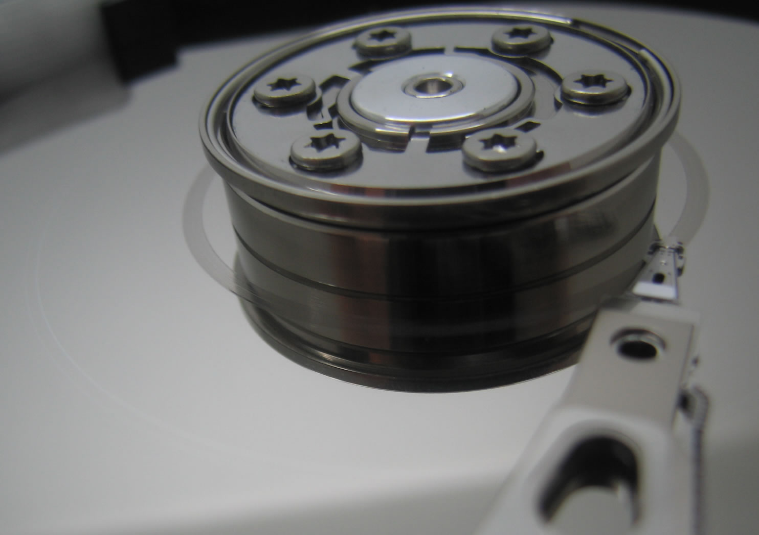

Platter have this:

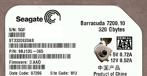

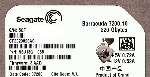

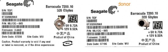

 Post subject: Re: SEAGATE HEAD CHANGE
PostPosted: March 4th, 2009, 11:35
Posts: 1421
Location: EUROPE
Hi Dobre,
The original PCB is OFF :(
Flash Rom Erased

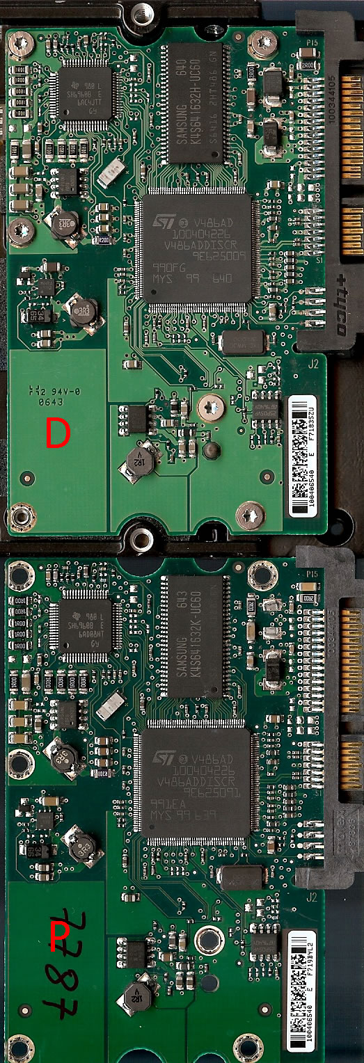

PostPosted: March 6th, 2009, 14:53
Posts: 1421
Location: EUROPE
Hi ccc,
Look at my patient / donor :
What do you think is possible to have different preamp ?
ZeBong
PostPosted: March 13th, 2009, 1:31
Posts: 1079
Location: canada
check the preamp ic-chip and see if its matches with the other one
it looks to use that its using a diffrent type ic
dirty tricks of seagate to stop us recovering hard drives :(

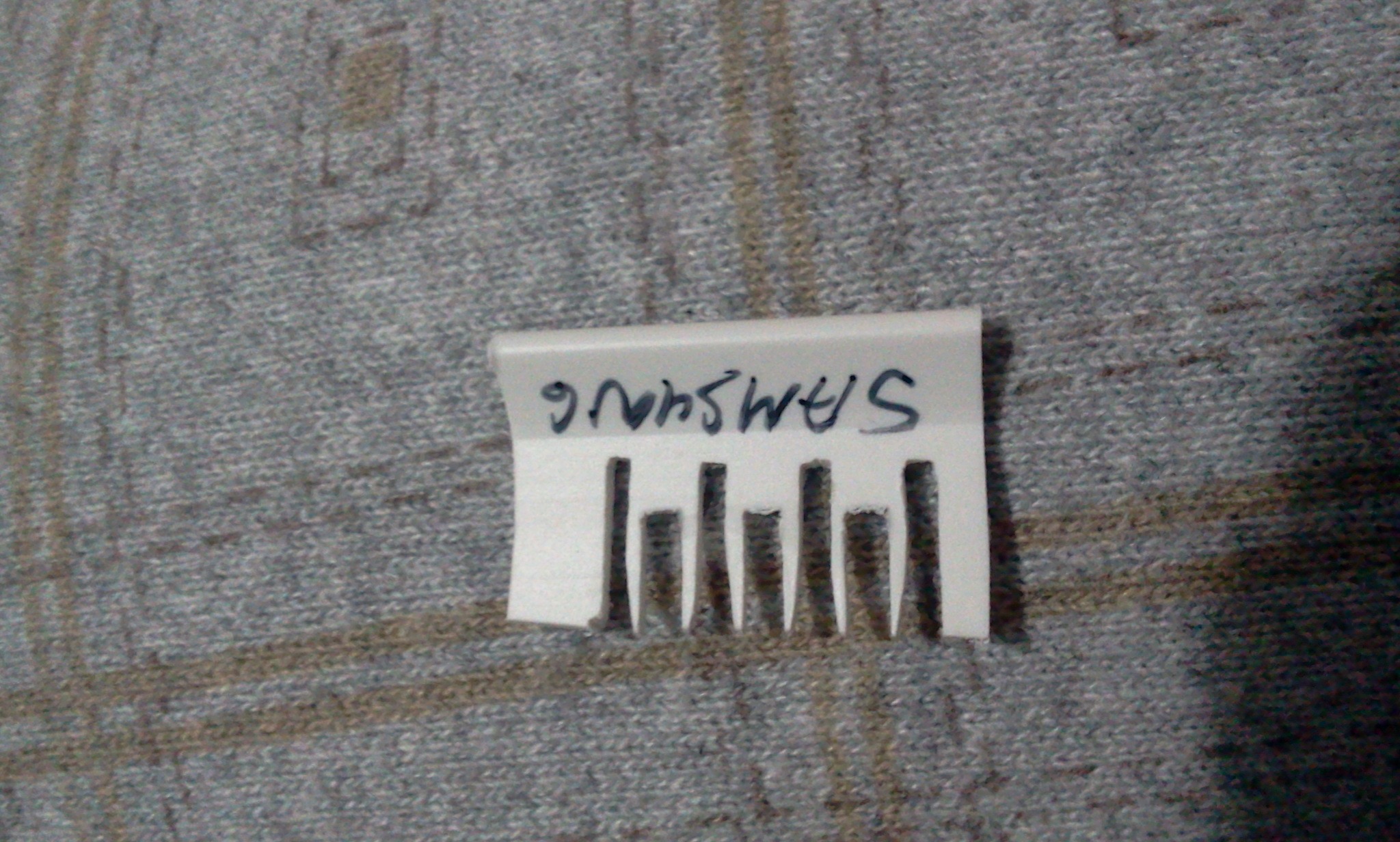

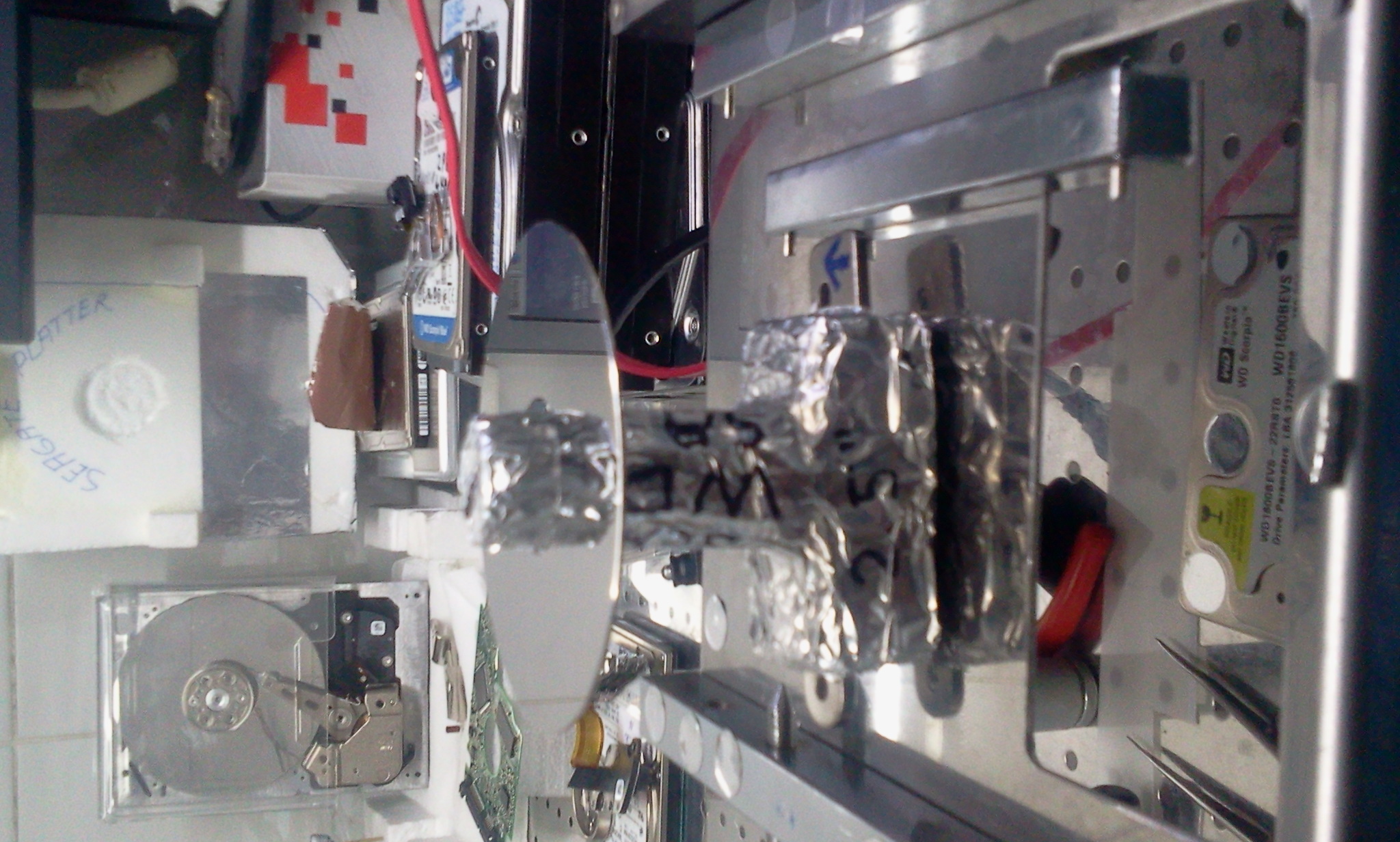

hi , How do you do the scratches on your disc surface
used during the head is broken

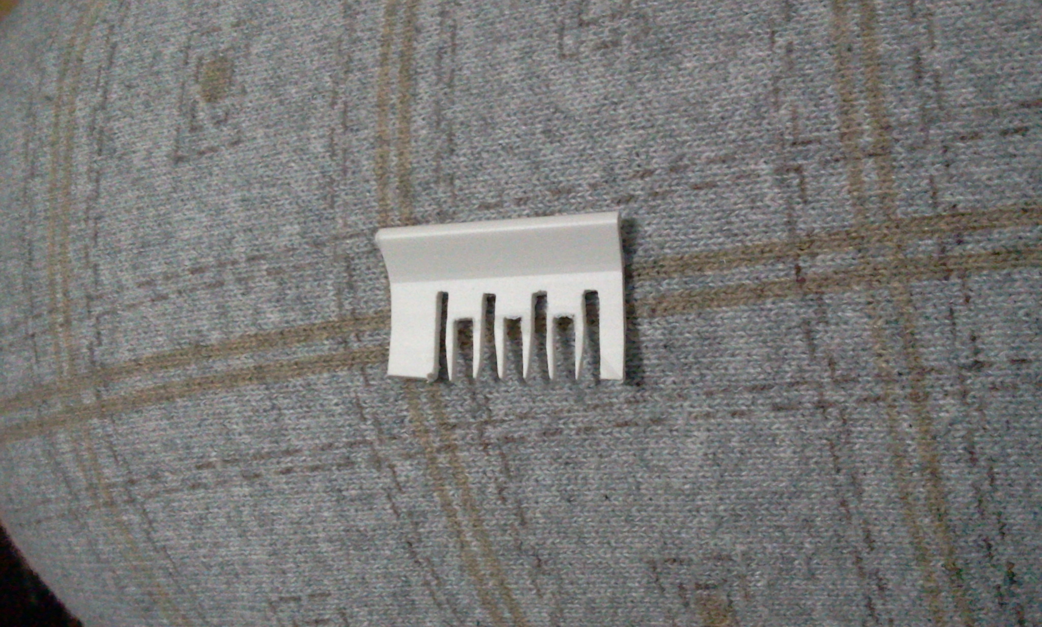

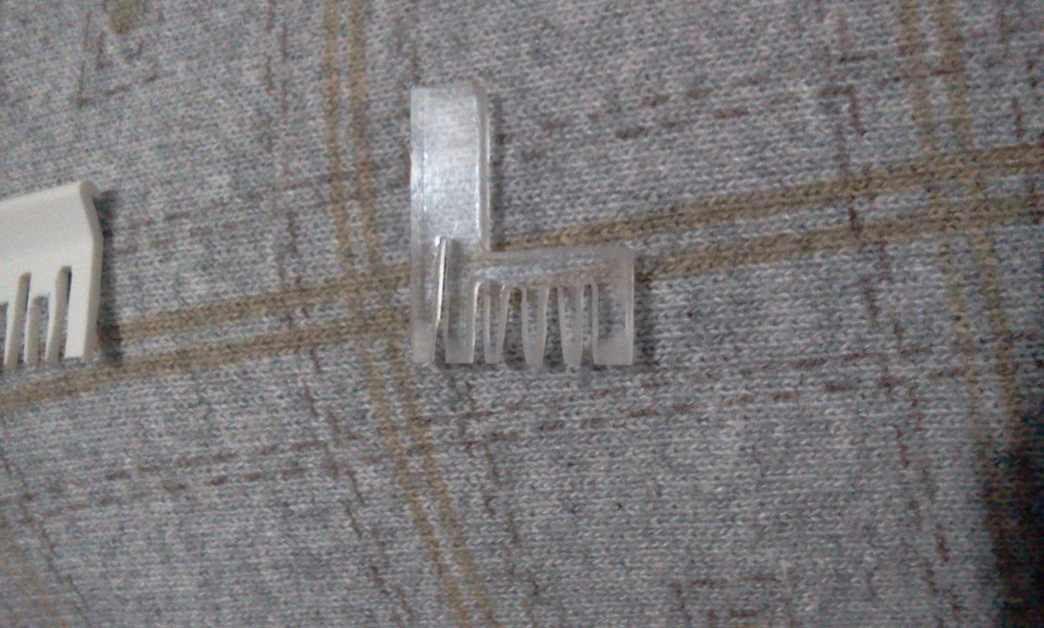

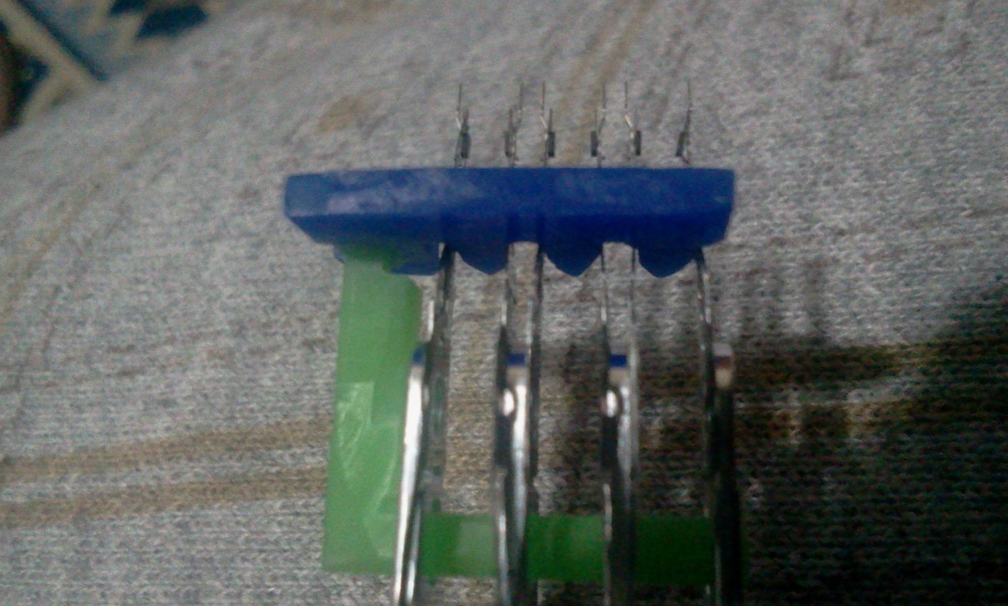

PostPosted: February 4th, 2013, 18:55
Joined: April 7th, 2011, 11:42
Posts: 13
Location: turkey

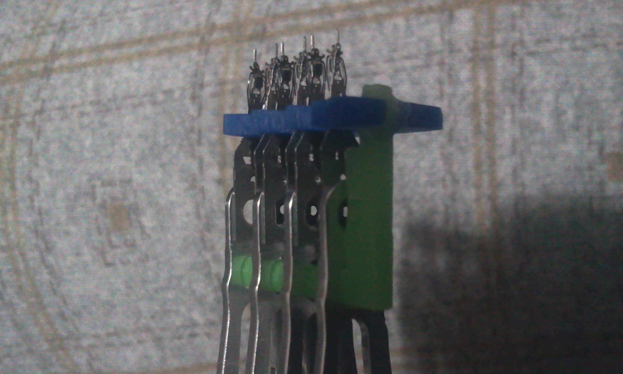

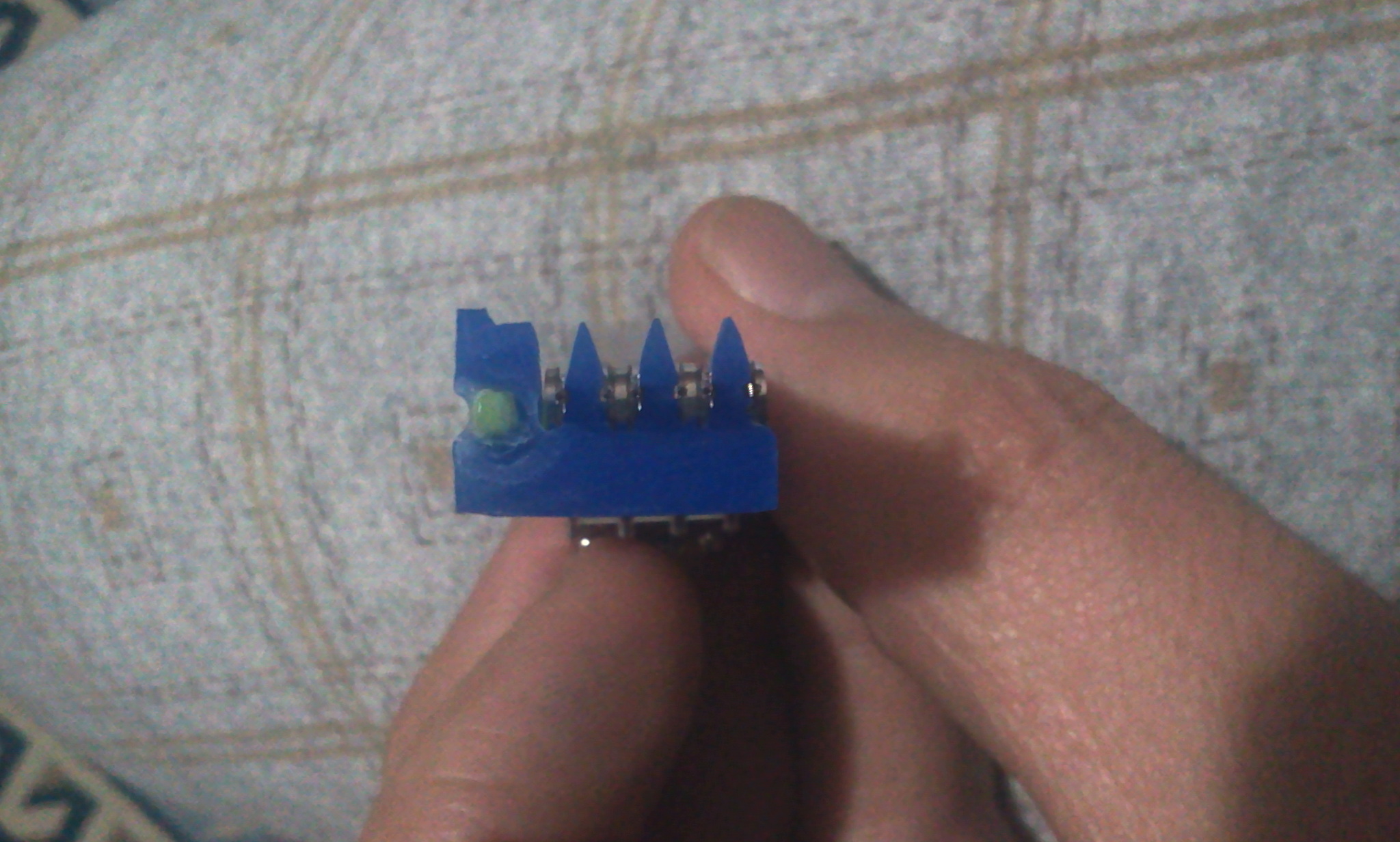

hi dear friends you can turn head tool
PostPosted: February 8th, 2013, 20:26
Posts: 13
Location: turkey
hi, data recovery device for scratched surface
could you give information
