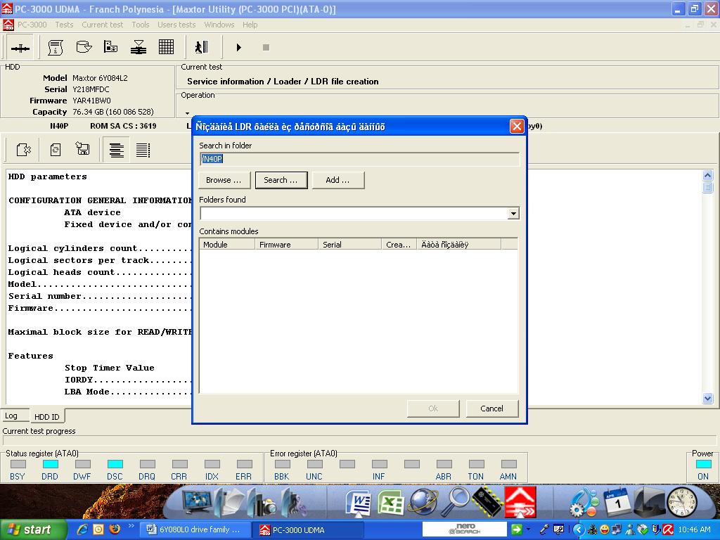

Quick update. I no longer think this is an OS issue with my program. I think that I got a bad program somehow from ACE. I reloaded the OS and did all that everyone has told me to do and now whern I bring up my menus things are still the same but now easier to read. I have Russian and English mixed together inside my program and it is driving me crazy to understand all of this mess. I have a item to click on and you can kind of read the English under it and then their is Russian over the top of it. Even in the main screen at the top header it comes up in Russian and not in English Will post a screen shot so you can see what I am talking about. Do anyone else have this problem. Should I try and contact ACE again over all this I am not getting answers back to this problem and see if they will give me a new program to run with my PC3000 UDMA. Or does someone have an answer for what I can do to correct this problem myself. Have tried everything else will do what is needed so that I can read this program. Thanks for any help from all
Notice the open panel in the middle of the screen and read the top header line it is in Russian if I am not mistaken and is this normal for your program too?

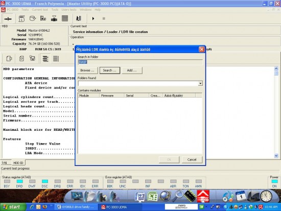

Have the same problem.

It's a problem with translation. Guys at Acelab couldn't translate all the menus for some reason and don't know what Unicode is about.
If you want to see Cyrillic characters instead of that garbage change Language for non-Unicode programs to Russian on Advanced tab in Regional and Language Options.

It's because the c0cks at Acelabia DO NOT TRANSLATE ALL RUSSIAN INTO ENGLISH (It drives me crazy ;o) ) So what you see is a bullsh1t character instead of the Russian character
Their stupid at this and I guess don't have a good BETA tester.....
