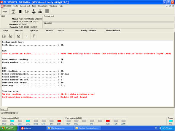

I have a WD Hard Disk WD800JD-60LSA0 with firmware problem.
Can you help me? see the image
best regards,
Carlos

Looks like it is a physical problem and not firmware. Try new PCB with ROM swap, but I believe heads may be damaged.
Was any work attempted on this already?
