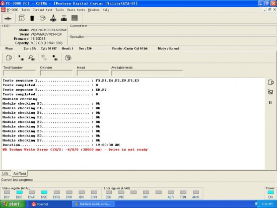

any help me to identify these error
i have 10 wd which is not detecting in bios, on pc-3000 it's making some errors
Thx
File comment: and when i lunch self test then it take this error what should i do for this ?

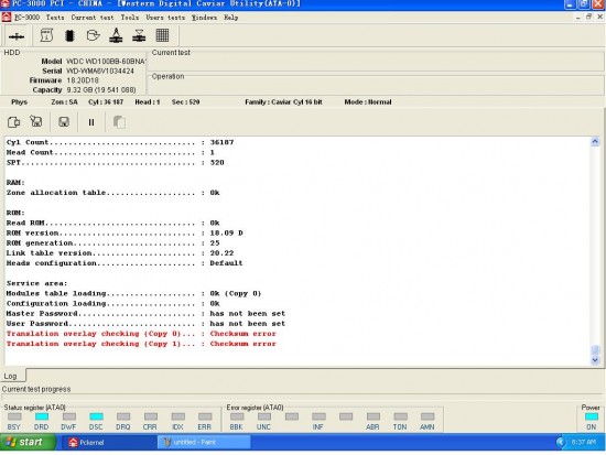

File comment: When i connect the drive after detecting it show me the same error

As you can see you have Translator problems, so you should first of all backup the FW and then regerate the translator.

Why are you starting selftest on the drive ?
 Post subject: Re: PC-3000 some error
PostPosted: April 26th, 2009, 5:51
Posts: 2984
Maybe as a last resort because the pirate version is a piece of sh*t and nothing else will work?? :mrgreen:
