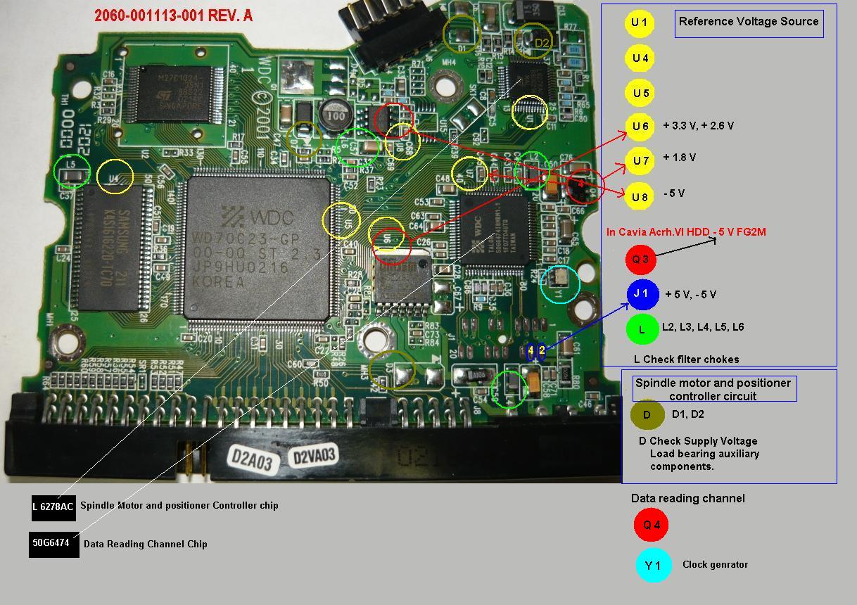

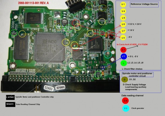

WD Pc trouble shooting easy way...
1. Reference voltage source
2. Checking filter
3. Spindle motor and positioner controller checking
File comment: WDxxxBB JB all model
