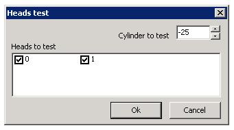

Have this disk WD400BB-77AUA1, when i connect to the udma it stays BSY forever.
So i found a similiar PCB
Patiente: 000 001003-001 G
Donor : 000 001003-000 C
When i change it , i could have ID, serial size, all the modules are ok in the utility, and i see two heads 0 1
I test the SA copy in the Composite reading , Copy 0 , Copy 1, and all the modules are green.
The info from service tracks i have this error but i think is normal for this model

When i start in DE and build the head maps it appear 3 Heads.
i start to clone, and i just can clone 41 215 sectors, after disk it give error reading any sector
Anyone have an opinion about this.

This HDD will have 3 heads enabled...
PS Probably U use PCB from 20GB or 30GB donor...
U not need ROM...
U must enable more 1 head...

Thanks Mikippp, the donor PCB was from a 20GB disk.
Can anoyone knows how much heads have this model ?
I enable one more head, and now in DE it appear 4 Heads.
Tomorow i will enable other Head, but would like to know if this model have 4 heads.

Enable 4 Heads, and cloning 100%
Thanks Mikippp :D
