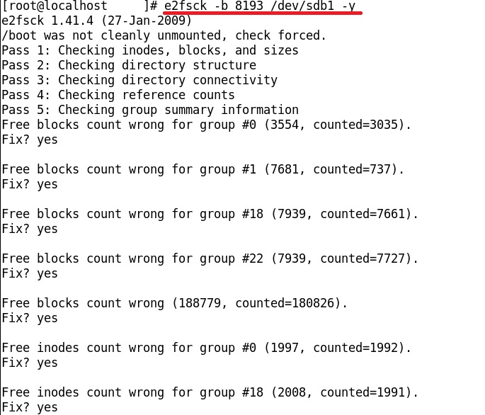

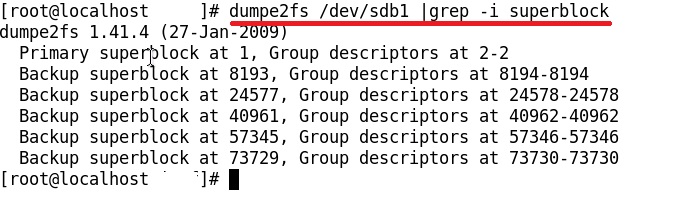

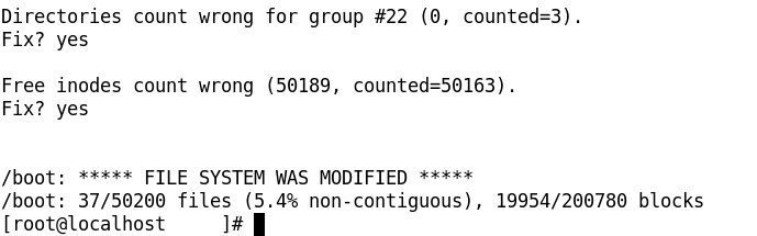

Hi again,
i could save about 80 % of the data but 20% is not appearing.
when i try that command in Linux i have this
What can i do more ?

Try with next backup block (24577)

Thanks to all,
i could make it.
