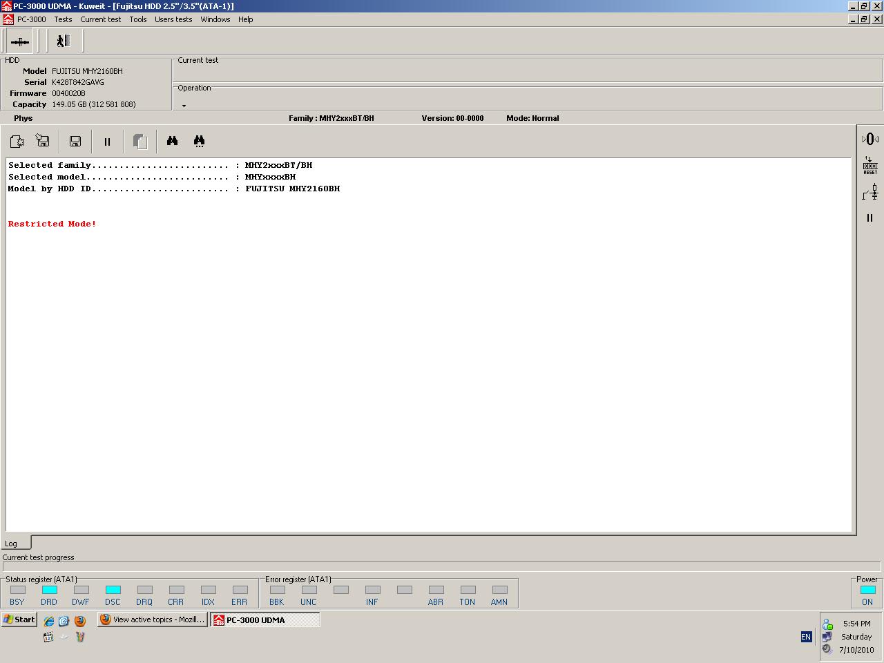

Dear Experts,
what does the restricted mode mean in pc3k for this fujitsu drive
it is a working HD and i tried to backup HD resources
but noticed this error message.
what does it mean???
thnx

PC3K does not support that series properly yet
