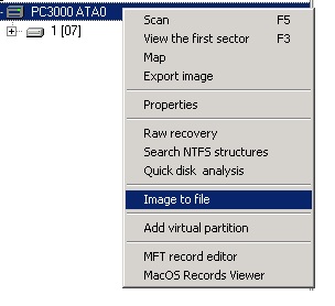

try this:

Bugger, does that make one BIG file?
 Post subject: Re: Data Extractor Image Files Join
PostPosted: September 15th, 2010, 15:55
Posts: 1421
Location: EUROPE
yes it makes an image of the size of the disk :(
do you know a way to make a smaller image ?

So it will image whole drive to a single file?
Silly me never even noticed that option... :OP
Problem with this way is that if Data Copy option is selected, which for most cases would be, then it will create the image files in addition to the single file - effectively 2 images.
