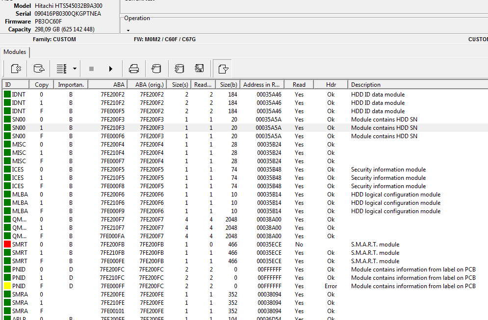

Smart modul error, What should I do my

Do you want to restore drive OR recover data?
 Post subject: Re: Hitachi Modules Problem
PostPosted: June 22nd, 2011, 11:05
Posts: 2848
this is SMART module not so important
clear it and ur fine

What seems to be the problem?
Have you tried accessing data sectors? What happens when you do?

when ı am triying to acces data of it, abort error appearred.after time out disk situation changes ready

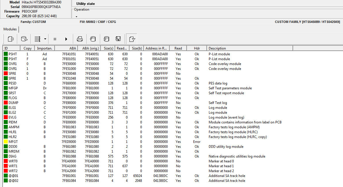

No other critical modules have errors?
no critical modules errors

asparajin wrote:

Run DE Create Head Map and try, one of the Head is Damage u can Disable Bad & Get Image of Good Heads.
