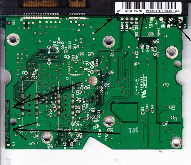

if i want to replace the pcb, only this pcb number is enough to replace the pcb, or have to consider on pcb sticker (white)
WD800ADFS, wd raptor
80gb
please advice
thanks

Hi Salim,
The one of the label 2061-701453-C00 AB and the one on the PCB 2060-701453-000 REV A would be desirable. Then you have to consider adapting ROM information.
