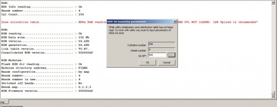

WD4000BEVT-00ZAT0
Attached problem.
what is solution?
PLease im new user of Pc3k
i tried ... not worked.

Hdd is unable to read the SA.

HDD looks like it can infact read SA, but some serious part of SA is damaged. I would guess here is likely your ATA overlay is bad (module #11.rpm), but could be a number of things.
First thing to do is check if you have donor firmware with version 000600AP. If not then you need to find it.
At the screenshot you posted press the '...' button next to 'SA SPT' it should correct the value. If not, leave it at 500 for now.
Next you should see if SA Dir reading is successful.
labtech is right in that you need to get a better understanding of the tools and the disks. This problem you have in this case is easier to make worse than it is to make it better, especially if you are not totally sure about what your doing.
