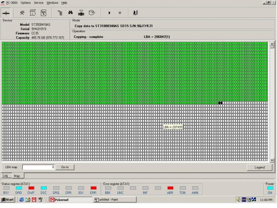

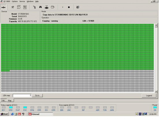

Hi everyone,
I have another case, it´s a Seagate ST500418AS.
The hard disk is recognizing, the mirror is slow and after same minutes the hard disk isn't recognized.
I need to turn off/on and i need skip same sectors to start again. if i'll do it, the files won´t open in the end.
Can anyone help me, please?
The pc3k is Chinesa.
Tks

This symptom can be solved by disabling pending operations in HDD.

@hddguy ,
Its F3 arch drive .

Guys, I work with data recovery but i can solve phisical problems... i don´t know very much about pc3k.
Where can i looking for about "disabling pending operations in HDD"???
