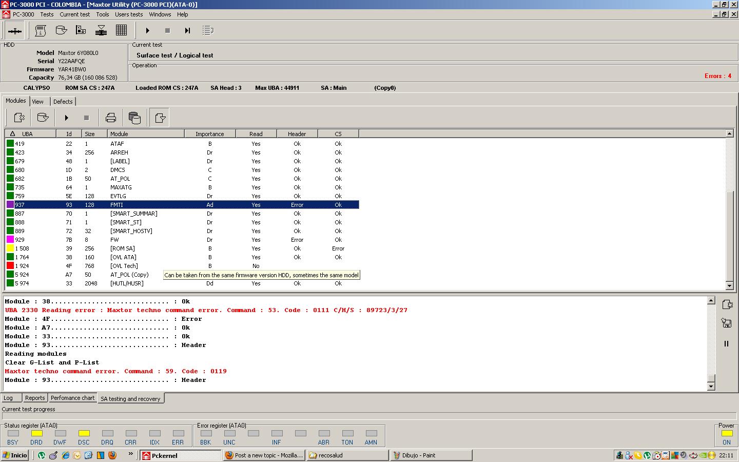

 Post subject: I need header module repair in Maxtor
PostPosted: January 19th, 2012, 23:16
Joined: February 17th, 2009, 13:01
Posts: 111
Location: Bogotá, D.C.

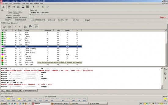

Modulo is FMTI with header error, please help me.
See the image please.
this is the SA Structure Test:
SA structure test

HDD configuration module
Id ........................................ 1F
Read ...................................... Yes
Header .................................... DISK
Checksum .................................. Error
Model ..................................... Maxtor 6Y080L0
Serial number ............................. Y22AAFQE
Max LBA ................................... 160086528
Head number ............................... 2
Head map .................................. 2 3

Checking ROM Copy
Check sum Value ........................... 247A
Checking ATA overlays
Header1 ...................................
Header2 ................................... ....
OverlayId ................................. 0000
ROM CRC ................................... Error

0 54 2 28881 34447
0 58 2 34448 40014
0 62 2 40015 45580
0 66 2 45581 51146
0 70 2 51147 56712
0 74 2 56713 62278
0 78 2 62279 67844
0 82 2 67845 73410
0 86 2 73411 78976
0 90 2 78977 84542
0 94 2 84543 89697
Checking RZTbl-HList
Beg.Cyl. End Cyl. :Def.count Def.count (PList)
1046 - 6612 :0 / 137
6613 - 12179 :0 / 120
12180 - 17746 :0 / 74
17747 - 23313 :0 / 45
23314 - 28880 :0 / 46
28881 - 34447 :0 / 79
34448 - 40014 :0 / 11
40015 - 45580 :0 / 7
45581 - 51146 :0 / 9
51147 - 56712 :0 / 162
56713 - 62278 :0 / 6
62279 - 67844 :0 / 36
67845 - 73410 :0 / 2
73411 - 78976 :0 / 69
78977 - 84542 :0 / 93
84543 - 89697 :0 / 6
Checking HLists
Block0
Header .................................... UHRS0000
Defect Count .............................. 540
Checksum .................................. Ok
Block1
Header .................................... UHRS0010
Defect Count .............................. 6
Checking security
Header .................................... SECU
User Password ............................. "********************************"
Master Password ........................... "********************************"
User password setup ....................... No
Master code ............................... FFFE
Security level ............................ HIGH
Checking S.M.A.R.T.
[SMRT_T] .................................. Ok
[SMRT_A] .................................. Ok
[SMRT_AC] ................................. Ok
[SMART_SUMMAR] ............................ Ok
[SMART_ST] ................................ Ok
[SMART_HOSTV] ............................. Ok
Checking FMTI
Id ........................................ 93
Header .................................... Error
Checking [DISK/PW]
not found
Checking All
Module 00 ................................. Ok
Module 01 ................................. Ok
Module 03 ................................. Ok
Module 04 ................................. Ok
Module 05 ................................. Ok
Module 08 ................................. Ok
Module 09 ................................. Ok
Module 0A ................................. Ok
Module 0B ................................. Ok
Module 0C ................................. Ok
Module 0D ................................. Ok
Module 0E ................................. Ok
Module 0F ................................. Ok
Module 10 ................................. Ok
Module 11 ................................. Ok
Module 12 ................................. Ok
Module 13 ................................. Ok
Module 14 ................................. Ok
Module 16 ................................. Ok
Module 18 ................................. Ok
Module 19 ................................. Ok
Module 1A ................................. Ok
Module 1B ................................. Ok
Module 1C ................................. Ok
Module 1D ................................. Ok
Module 1E ................................. Ok
Module 1F ................................. Ok
Module 20 ................................. Ok
Module 21 ................................. Ok
Module 22 ................................. Ok
Module 24 ................................. Ok
Module 27 ................................. Ok
Module 28 ................................. Ok
Module 29 ................................. Ok
Module 2A ................................. Ok
Module 2B ................................. Ok
Module 2D ................................. Ok
Module 2F ................................. Ok
Module 30 ................................. Ok
Module 32 ................................. Ok
Module 33 ................................. Ok
Module 34 ................................. Ok
Module 37 ................................. Ok
Module 38 ................................. Ok
Module 39 ................................. Ok
Module 41 ................................. Ok
Module 42 ................................. Ok
Module 43 ................................. Ok
Module 44 ................................. Ok
Module 45 ................................. Ok
Module 46 ................................. Ok
Module 47 ................................. Ok
Module 48 ................................. Ok
Module 49 ................................. Ok
Module 4A ................................. Ok
Module 4B ................................. Ok
Module 4C ................................. Ok
Module 4D ................................. Ok
Module 4E ................................. Ok
Module 4F ................................. Ok
Module 54 ................................. Ok
Module 55 ................................. Ok
Module 56 ................................. Ok
Module 57 ................................. Ok
Module 58 ................................. Ok
Module 59 ................................. Ok
Module 5A ................................. Ok
Module 5B ................................. Ok
Module 5C ................................. Ok
Module 5D ................................. Ok
Module 5E ................................. Ok
Module 5F ................................. Ok
Module 60 ................................. Ok
Module 61 ................................. Ok
Module 62 ................................. Ok
Module 63 ................................. Ok
Module 64 ................................. Ok
Module 65 ................................. Ok
Module 66 ................................. Ok
Module 67 ................................. Ok
Module 68 ................................. Ok
Module 69 ................................. Ok
Module 6A ................................. Ok
Module 6B ................................. Ok
Module 6F ................................. Ok
Module 70 ................................. Ok
Module 71 ................................. Ok
Module 72 ................................. Ok
Module 73 ................................. Ok
Module 74 ................................. Ok
Module 75 ................................. Ok
Module 76 ................................. Ok
Module 77 ................................. Ok
Module 78 ................................. Ok
Module 79 ................................. Ok
Module 7A ................................. Ok
Module 7B ................................. Ok
Module 81 ................................. Ok
Module 82 ................................. Ok
Module 83 ................................. Ok
Module 84 ................................. Ok
Module 85 ................................. Ok
Module 86 ................................. Ok
Module 87 ................................. Ok
Module 88 ................................. Ok
Module 89 ................................. Ok
Module 8A ................................. Ok
Module 8B ................................. Ok
Module 8C ................................. Ok
Module 8D ................................. Ok
Module 8E ................................. Ok
Module 8F ................................. Ok
Module 90 ................................. Ok
Module 92 ................................. Ok
Module 93 ................................. Ok
Module 94 ................................. Ok
Module 96 ................................. Ok
Module 97 ................................. Ok
Module 98 ................................. Ok
Module 99 ................................. Ok
Module 9A ................................. Ok
Module 9B ................................. Ok
Module 9C ................................. Ok
Module 9D ................................. Ok
Module 9E ................................. Ok
Module 9F ................................. Ok
Module A1 ................................. Ok
Module A2 ................................. Ok
Module A5 ................................. Ok
Module A6 ................................. Ok
Module A7 ................................. Ok
Module A9 ................................. Ok
Module AA ................................. Ok
Module B1 ................................. Ok
Carlos
