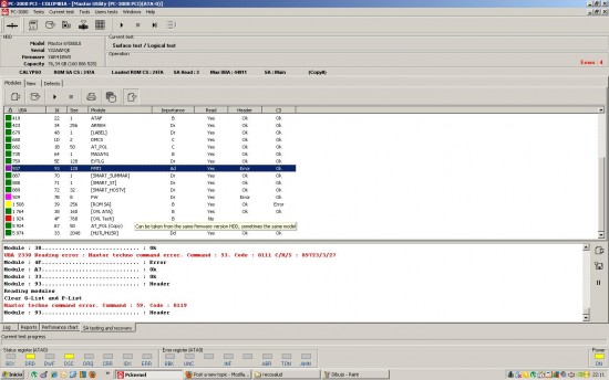

Author:  ccamargol [ January 19th, 2012, 23:16 ]
Post subject:  I need header module repair in Maxtor
Modulo is FMTI with header error, please help me.
See the image please.
this is the SA Structure Test:
SA structure test

HDD configuration module
Id ........................................ 1F
Read ...................................... Yes
Header .................................... DISK
Checksum .................................. Error
Model ..................................... Maxtor 6Y080L0
Serial number ............................. Y22AAFQE
Max LBA ................................... 160086528
Head number ............................... 2
Head map .................................. 2 3

Checking FMTI
Id ........................................ 93
Header .................................... Error
Checksum .................................. Ok
Checking [DISK/PW]
not found

Carlos
