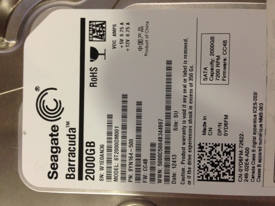

Hello to everybody . Im new around here but i have been reading this forum for a long time.
I am trying to solve a firmware issue, or at least its what i think its the problem, but with no success.
After getting reed of the LED error by short circuiting the Main Board i am getting this on the terminal.
The drive as soon as you try to read any sector it gets an UNC error and i have no access until a soft or hard reset
This is the terminal log:
Boot 0x40M
Spin Up
TCC-0020[0x00026F7C][0x000273E8][0x00027854]
Trans.
Rst 0x40M
MC Internal LPC Process
Spin Up
TCC-0020
(P) SATA Reset
RAW OFF
PASS
MCMainPOR: Start:
Check MCMT Version: Current
MCMainPOR: Non-Init Case
Reconstruction: MCMT Reconstruction Start
Max number of MC segments 0A61
Nonvolatile MCMT sequence number 00000013
[RSRS] 0000
Reconstruction: Completed 0: HeadPtr was unwritten
[MCMTWS]
MCMainPOR: MCTStateFlags 0000002A MCStateFlags 00000001
MCMainPOR: Feature Enabled...
PowerState = IDLE1
PowerState = IDLE2
Thanks and a nice afternoon to everybody.
File comment: Here are the drives specification

Sorry , the picture is flipped
