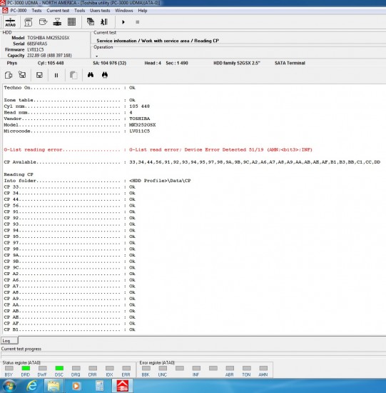

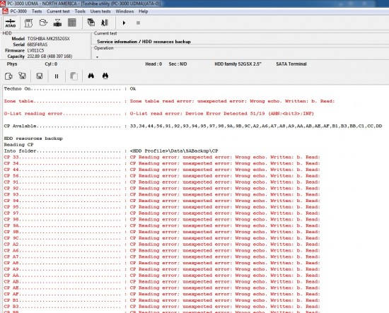

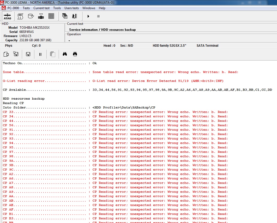

Okay, this is curious but a feature of Toshiba laptop drives.
This mk2552gsx IDs itself on PC300UDMA, but after launching
the Toshiba applet, I get the errors seen on the attachment.
I would like to know how to proceed to fix this. I suspect the
F/W needs rebuilding, as the drive otherwise sounds fine.
Thanks,
Drew

 Post subject: Re: Toshiba mk2552gsx ID's but no data
PostPosted: November 29th, 2013, 4:59
Posts: 1752
First of all, what's the beaviour of your drive?
Do you have sector access?
Do you have terminal connected?
PostPosted: November 29th, 2013, 8:37
Looks like you don't have the terminal (COM port) connection connected, as dmarques mentioned.

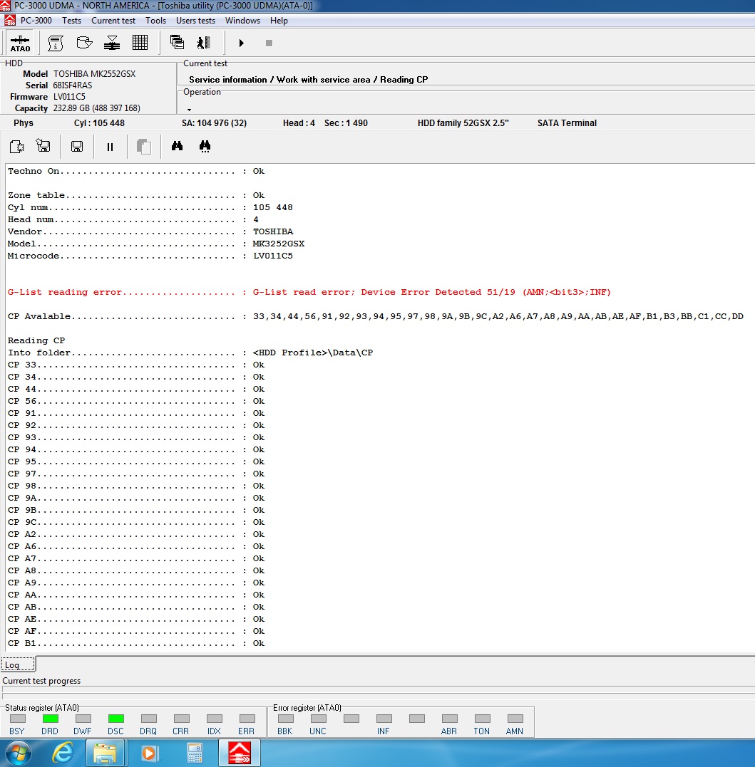

Oops, you are right. Here is the new picture:
I was able to to a full resources backup after
connecting the Toshiba plug.
Any help you can give would be greatly appreciated.
-D
