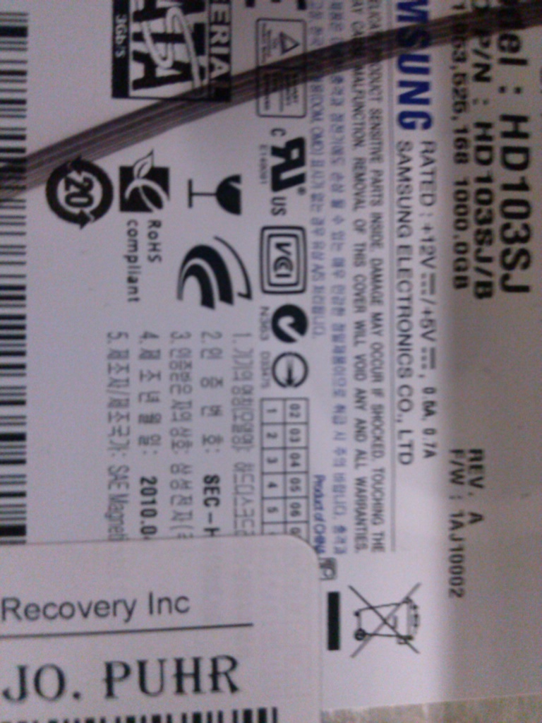

 Post subject: Re: HD103SJ ROM ver 1AJ10002
PostPosted: January 14th, 2014, 15:36
Thanks, have plenty of that version.
See pic, please.
PostPosted: January 15th, 2014, 5:43
Posts: 2848
See pic, please.
yes, i can see that, when i 1st. looked i thought its SI not SJ
my mistake :>
:wink:
