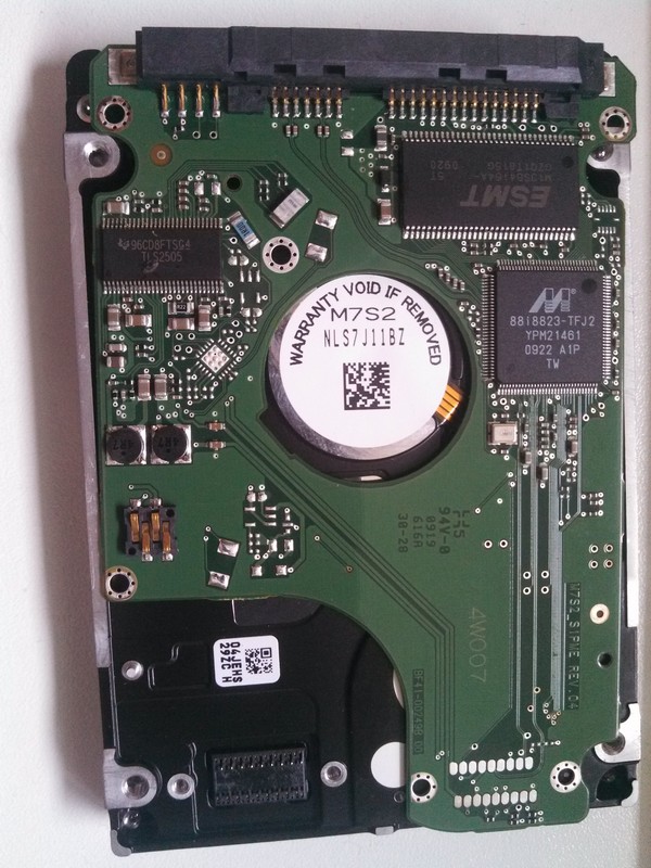

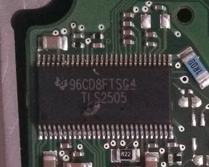

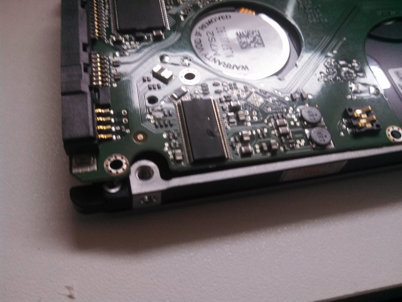

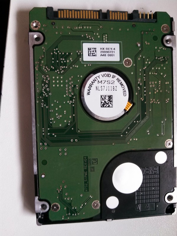

Here are some pictures of the PCB
Can you notice why I think this PCB is HS ?

The motor controller chip is obviously damaged, so PCB repair is probably not a realistic option. Have you tried the donor PCB on the patient drive?
I confess that I don't understand the reason behind copying the patient's SA modules to the donor. However, ISTM that "No Overlay code" means that the donor cannot locate the MOVLY001 module.
I have a general idea for resurrecting a PCB with a dead motor controller, provided that the MCU and its support devices are OK. It involves powering the board from external Vcore and Vio supplies, and validating the POK signal to the MCU. You should then by able to communicate with the MCU via its serial terminal interface.
