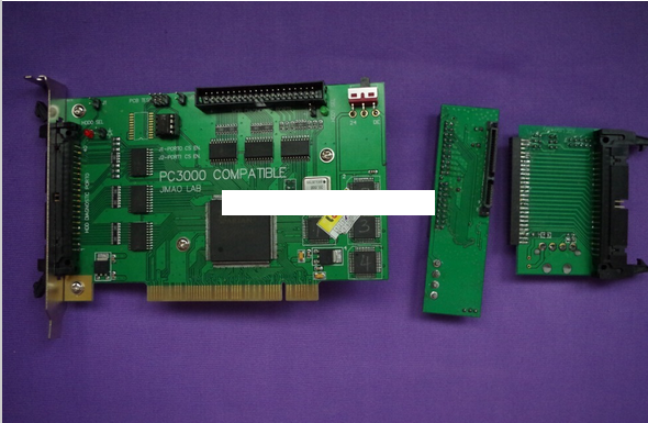

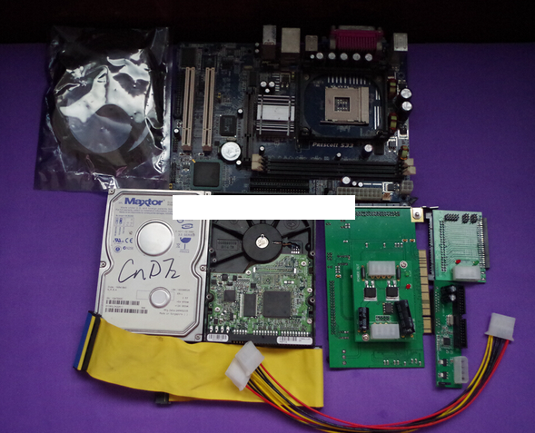

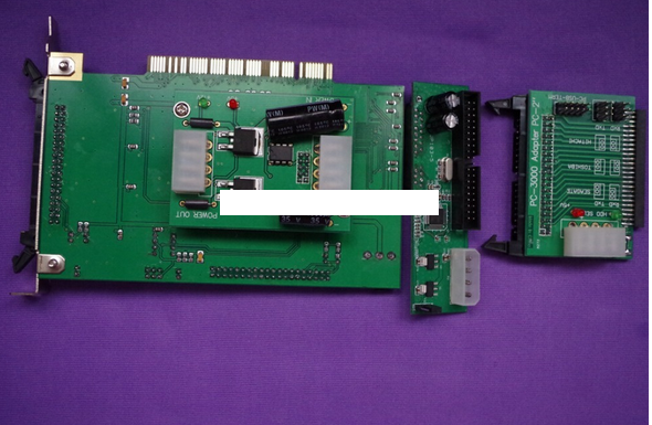

Hello folks!
I'm a newbie in Recovery data.
I've some questions about the PC-3000.
I saw the following for sale (see picture attached)
The mainboard + 2 hardrives are included (i guess for the PC-3K licence?)
Is this a completed set with all the neccessary adapters included?
When i checked the site from Ace by 'Procucts -> Data recovery from HDD -> PC-3000 Express system'
they offered more adapters than on this picture.
For example; 10x drives adapters; PC-USB terminal adapter, MX safe adapter and the ATDS/ATDA adapter.
Anybody who can tell me if i can trust to buy this licence + hardware tools?

This is counterfeit copy of outdated PCI version of PC3000 :evil:
as per pcimage, that would be a "NO" -
Even if it was genuine, afaik, the licensing on Acelabs gear still does not permit "to sell on" their goods second hand, so you would get no support.

That's the cheaper clone version and probably has updates only to 2003/2004ish. Quite useless in today's world.

PC3000 PCI V2.5 + Data Extractor V2.2:
http://www.drivestar.biz/hdd-tool-pc300 ... 4_132.html
http://www.drivestar.biz/pc3000-pci-v25 ... p-298.html
Supported HDD list of PC3000 PCI:
http://www.drivestar.biz/files/pc3000pcisupport.pdf
This tool was released in 2007 and cannot upgrade to support the latest hard drives.

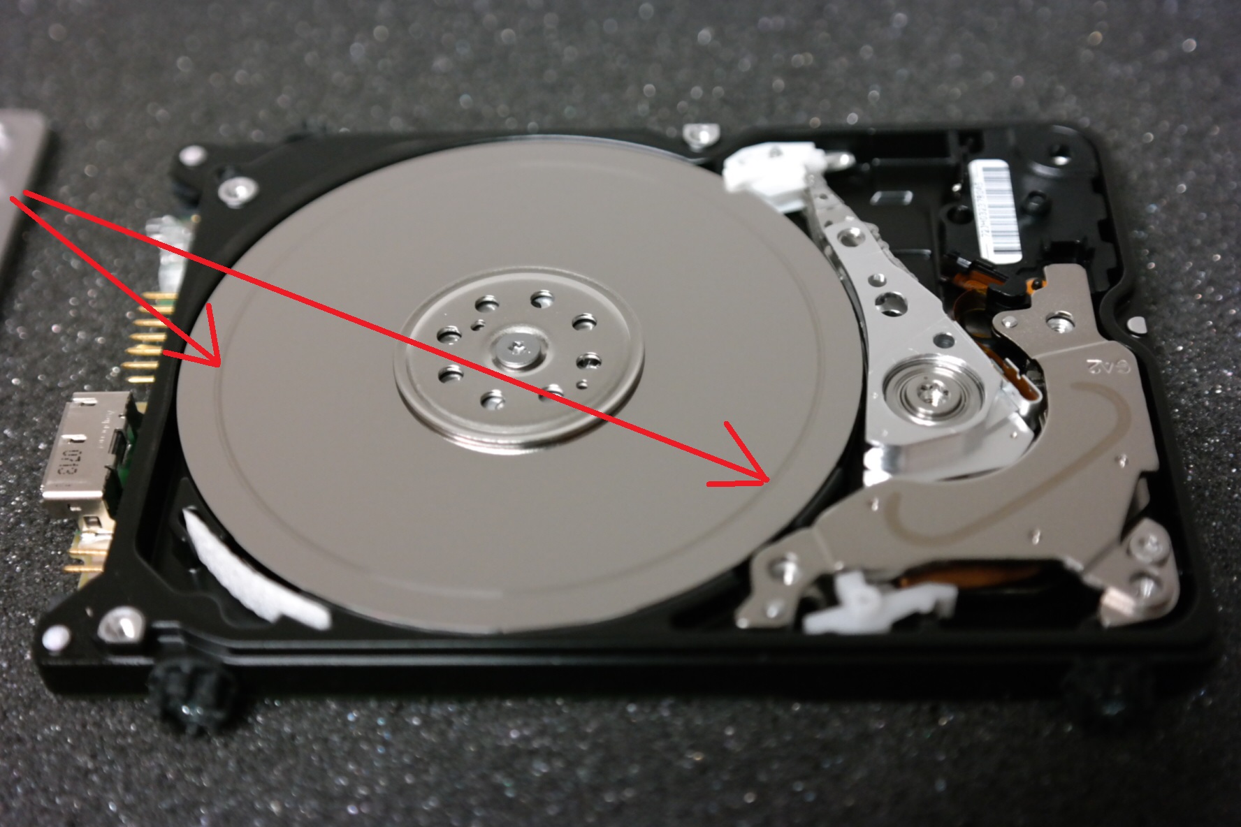

Today i had i client in my shop with a noisy hd (not clicking).
I opened the drive and saw the following (see picture!)
The plat is scratched on the outer side of the platter.
The hd is an external WD 1TB (without sata connection)
I tried before i opened with some software tools (HD regenerator, HDD raw copy tool etc).
But it came only worser because the more the drive was running the more it was scratched! :?
Somebody know if this could be repaired.
Thanks...

Hdd "regenerator" is quite possibly the very reason the scratch has manifested itself in quite such a bad way. :-(
Sorry to say, but you've probably made this drive extremely difficult to recover, if at all possible :-(

No way! HDDRegenerator will use sonic pulses to rebuild the scratched zones on the platters and clean the dust of the heads.
On a serious note, this is the perfect case of why HDDRegenerator is NOT a data recovery tool. Sorry.
