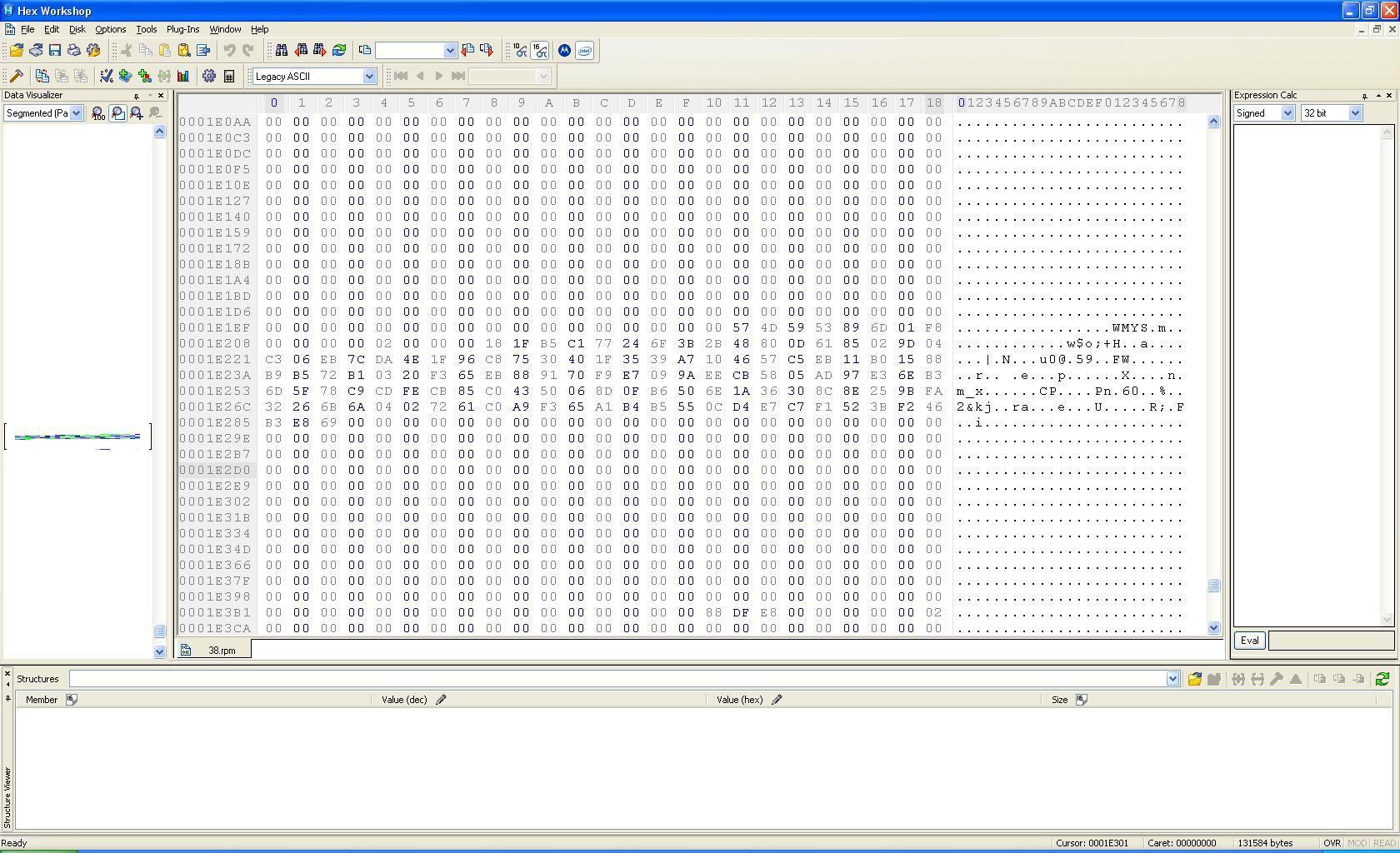

hi all
very sorry
clone is end .
this is madule 25 and 38
madule25
0x0000 52 4F 59 4C 01 00 30 00 25 00 01 01 21 49 0D 2D ROYL..0.%...!I.-
0x0010 30 30 31 30 30 30 30 55 07 07 07 00 00 00 00 00 0010000U........
madule 38
0x0000 52 4F 59 4C 01 00 30 00 38 00 01 01 32 55 8A C9 ROYL..0.8...2UŠÉ
now what do i do?
 Post subject: Re: Wd usb3 recovery!!
PostPosted: September 4th, 2014, 18:47
Posts: 17323
The key sector(s) would be at offset 0x200 within the module.
BTW, I believe that PC3K has a software based solution for your case.

mdule 38 is such this madule 25
all line is zero

an example of mod 38 from Sadle G6 WD20EARS-00MVWB0-51.0AB51 drive encrypted with symwave
38.rar [408 Bytes]
Downloaded 1001 times

now what do i do by madule 38?
