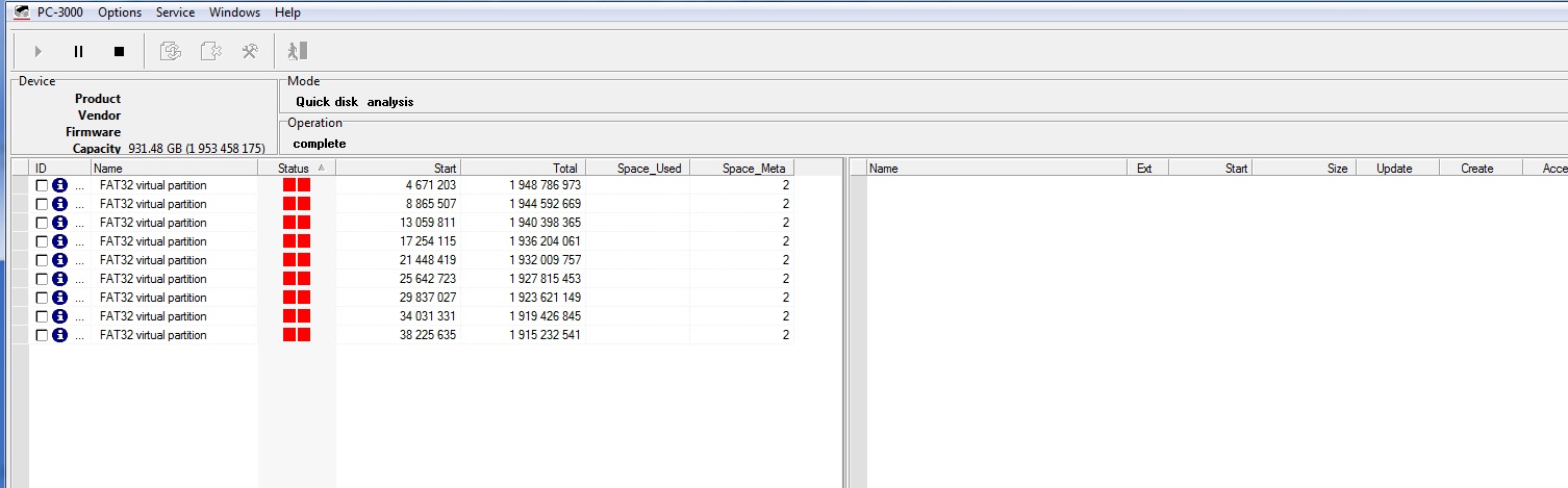

Hello, i need help!
Customer has 1TB FAT32 drive, 12 inaccessible sectors around the FAT means i have to run a full analysis. Of the 2 billion sectors i get to about 38million and recieve these errors:
FAT Folder at LBA=   38 686 307
    FAT Folder at LBA=   38 703 843
    FAT Folder at LBA=   38 714 595
    FAT Folder at LBA=   38 781 603
[EOleException] TFDA_Analizer.FindFsObj -> Out of memory

It does not seem to be the RAM. I added 2x2GB sticks to give me a total of 8GB. I received the same error, in nearly the same place:

[12/13/2014 6:30:41 PM] Quick disk  analysis  (complete)
[EOleException] TFDA_AnalizeThread.InternalExcecute -> Storage stream saving error (code 5) : Out of memory (before exec)
Task parameters saving: 12/13/2014 6:35:47 PM
Attached is an image of the broken FAT32 partitions i found before block 38 million. I'm lost, not sure what i should try now.. :P
File comment: Found FAT32 partitions before block 38 million...

It is probably a bug with the software, your quickest option is probably to scan the image with other data recovery software, such as R-Studio.
Unless anyone knows a workaround for the bug; are you running the latest version of the software?
Also, is the application 32-bit or 64-bit?
http://msdn.microsoft.com/en-us/library ... ory_limits
It may not be able to use more than 2GB of RAM.

Thanks for the good advice! I'll try RStudio today.
My PC3000 kernel is located in:
C:\Program Files (x86)\ACE Lab\PC-3000\Bin\PC3000Kernel.exe
Besides me having a x64 system. So it seems i have a 32-bit version of PC3000 installed? Unfortunately i can't see a 64-bit alternative on the official update server. :S
