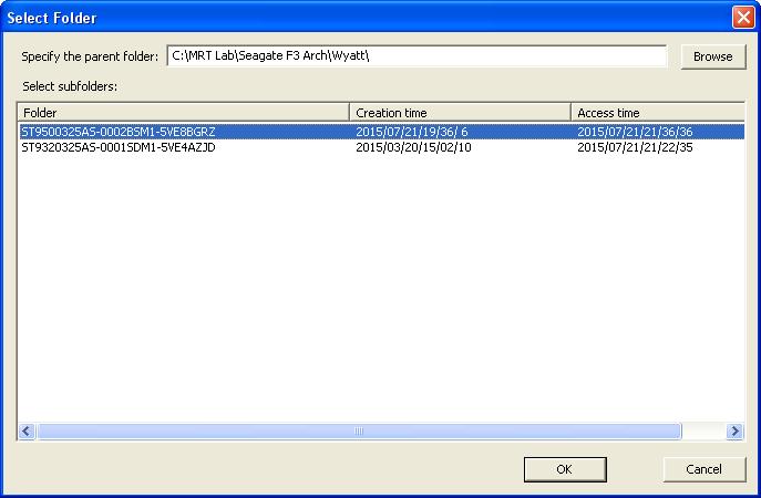

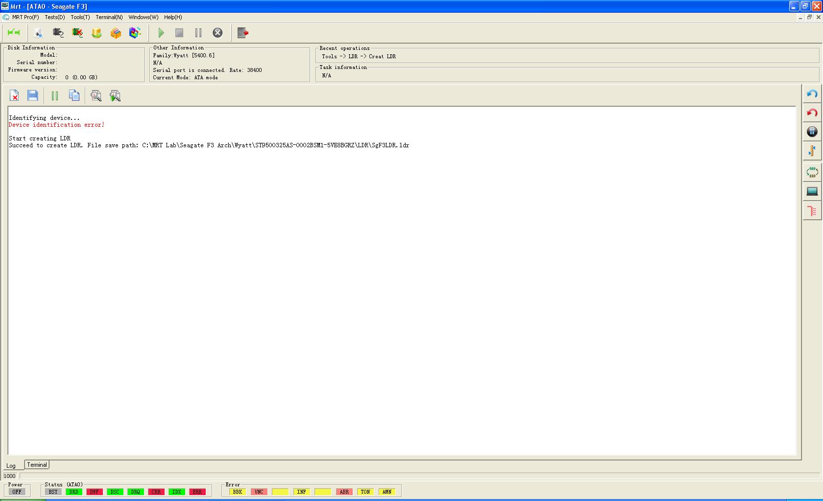

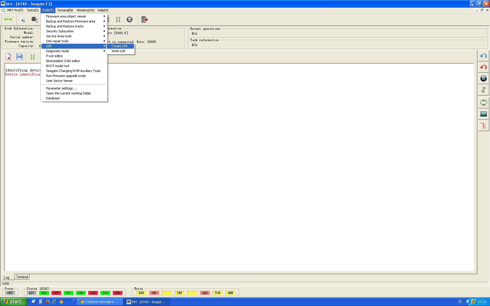

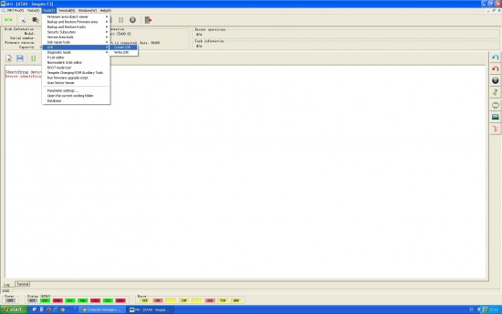

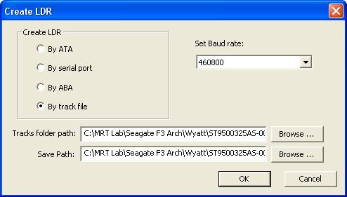

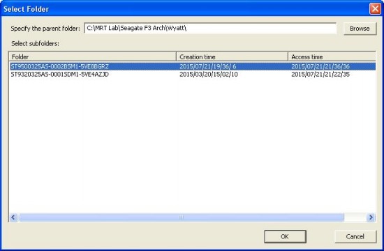

Some pics to show you how i created LDR by track in MRT...
My firmware database:
