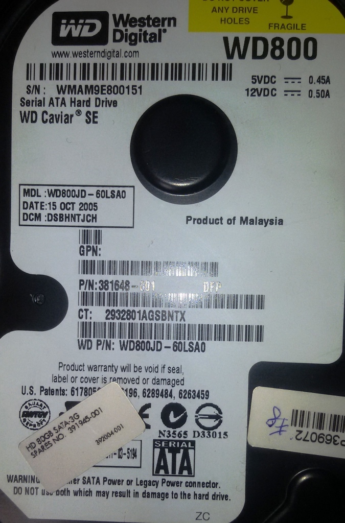

Hello
Could anyone provide the loader for WD800JD-60LSA0 hdd please
Kind regards

PC3KUDMA auodetect model sabre58
 Post subject: Re: WD800JD-60LSA0
PostPosted: January 16th, 2015, 6:18
Joined: September 9th, 2014, 6:34
Posts: 10
Location: Italy
PCB model 2060-701335-005 rev.A
File comment: HDD front label
PostPosted: January 16th, 2015, 8:23
Sorry, I don't have that version.
In any case, if the drive clicks and spins down then it's almost certainly a physical issue (e.g. heads bad)
