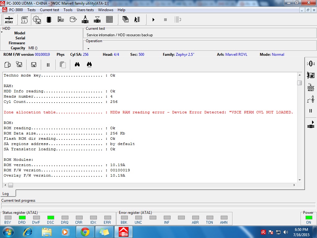

Hello every body , this my first topic on this site
I am new in data recovery field and using PC3k UDMA , i have a WD5000BMVW-11AMCS0 Family:zephyr with USB PCB the hdd not recognized i swapped the PCB from (USB 2060-771737 To SATA 2060-771692) so i can connect it to the pc3K and sure swapped the U12 ROM
the problem is when i initialize the utility the following error popup:
Techno mode key
Techno mode key......................... : Ok
RAM:
HDD Info reading........................ : Ok
Heads number............................ : 4
Cyl Count............................... : 256
Zone allocation table................... : HDDs RAM reading error - Device Error Detected: "VSCE PERM OVL NOT LOADED. LDR Upload is recomended"
ROM:
ROM reading............................. : Ok
ROM Data size........................... : 256 Kb
Flash ROM dir reading................... : Ok
SA regions address...................... : by default
SA Translator loading................... : Ok
ROM Modules:
ROM version............................. : 10.19A
ROM F/W version......................... : 00100019
Overlay F/W version..................... : 10.19A
Servo F/W version....................... : 02.17
Heads number in use..................... : 4
Switched off heads...................... : No
Heads map............................... : 0,1,2,3
Service area:
Permanent overlay....................... : Not loaded
SA dir reading (ID)..................... : Drive is not ready
SA dir reading (ABA/CHS)................ : Techno key error; unexpected error: Operation aborted
i think need the LDR File
any help would be appreciated
many thanks

Does the drive spin up and sound normal?
No clicking or spin down?

The hdd spin up normal no clicking voice but when power on the hdd start spin up and still in busy state until about 60 seconds and cant be auto dedcted after that the the hdd spins down and go to ready state

Here's the LDR for it: http://gofile.me/20ewd/dFbSbCjx
It's almost certainly bad heads in my opinion. But it's still worth trying to upload LDR, edit headmap in RAM, and see if you can jumpstart it. That or maybe do a smart hotswap.
