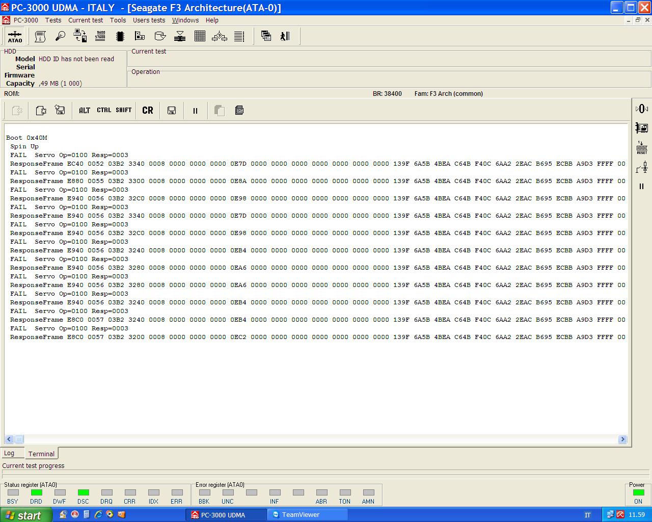

I have two disks with the same defect
ST1000DM003-CC4B date:12421 China
ST1000DM003-CC4D date:12383 China
after the spin-up the heads clicks (10 times) and then the motor stops
does not respond to commands from the terminal
can anyone help me or give me a hint?

Working on a similar case. I performed a head swap, and already got it to ID. Still some other issues tough.
So heads are the problem.

Most definitely heads, at the very least.

Thanks all for your attention!!
As I thought I should look for a donor
