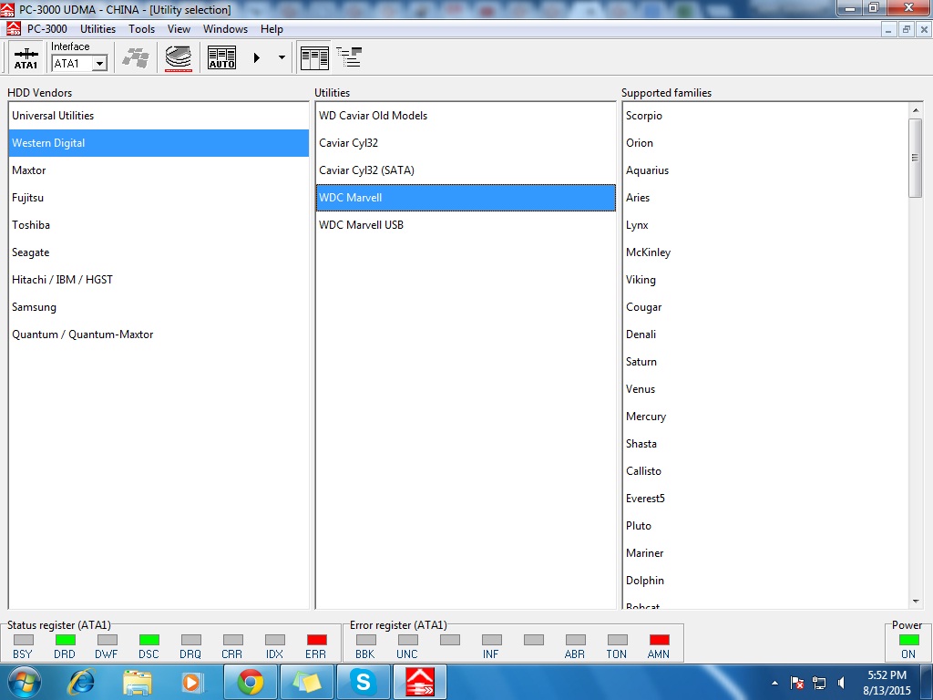

i have WD800JD-55MUA1 caviar 80 GB when connect it to pc3000 UDMA
Power on
1- spin up
2- three clicks sound and spin down
3- ERR & AMN indicator = red
the HDD can auto deducted but when utility starts it give me wrong information about the model and serial and capacity (See the attached pic)

the first thing i think its head problem need to swap but when i see the wrong outcome,
maybe wrong firmware or any thing else
so i stopped and asked the guru people you have diffidently a good experience

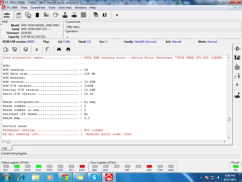

Techno mode key
Techno mode key......................... : Ok
RAM:
HDD Info reading........................ : Ok
Heads number............................ : 2
Cyl Count............................... : 64
Zone allocation table................... : HDDs RAM reading error - Device Error Detected: "VSCE PERM OVL NOT LOADED. LDR Upload is recomended"
ROM:
ROM reading............................. : Ok
ROM Data size........................... : 128 Kb
ROM Modules:
ROM version............................. : 10.8DE
ROM F/W version......................... : 108DE
Overlay F/W version..................... : 10.8DE
Servo F/W version....................... : 02.80
Heads number in use..................... : 2
Switched off heads...................... : No
Heads map............................... : 0,1
Service area:
Permanent overlay....................... : Not loaded
SA dir reading (ID)..................... : Unknown error code: 4343
Configuration reading................... : Module 02 not found

You can try with Ldr (if you have) but it seems weak heads.
 Post subject: Re: WD800JD-55MUA1 need an advise
PostPosted: August 17th, 2015, 12:30
Bad heads, at least.
PostPosted: August 17th, 2015, 16:26
You can try hot-starting it. Upload compatible LDR, edit headmap in ram to disable different heads, and soft-reset to see if it'll ID.
