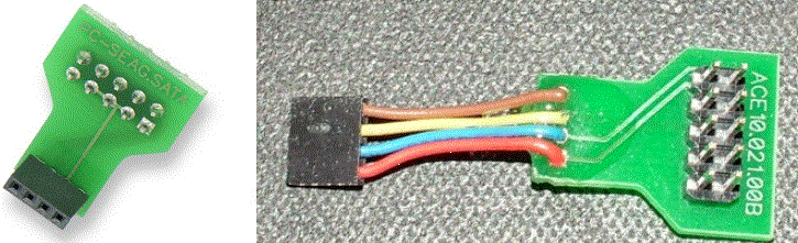

that adapter is for a Seagate sata HDD. so, find the pinout for a Seagate hdd first, then you know what each of the 4 pins are for. eg, vcc, gnd,tx,rx. then, connect gnd together on adapter and usb hdd, the TX to RX and the RX to TX.
you know what the usb hdd pinout is already. you don't need vcc.. get creative, use wires, poke pins in , whatever, doesn't matter as long as they are connected. solder wires to usb hdd if you have to.
BTW, this example was an example, make sure you check the adapter for the proper signal position and orientation.

Ahh okay, after looking at the Samsung adapter, there is no GND, only Tx and Rx, i assume that's why fzabkar recommended connecting USB-TTL to the HDD case?
Here is how i assume it would go, please tell me if i'm still being a noob:

but if you posted a pic of the Seagate one (not Samsung) it may be easier than that.. it looks as if the GND signal is actually on the reverse side of the PCB of the adapter.
realise the adapters are a little different, but I think pinout the same, tx,rx one side, gnd on the other 3 pins total.
ground is done for you.
