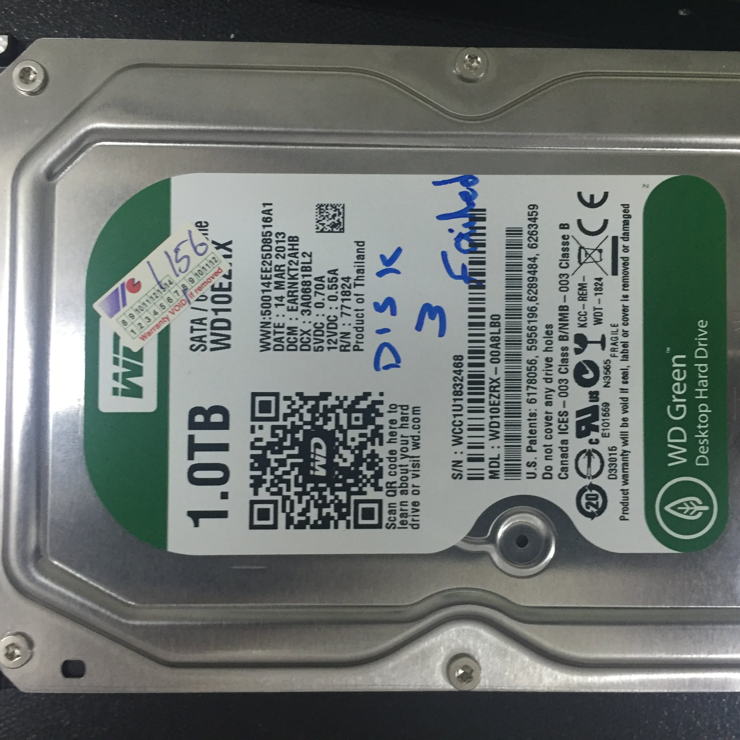

hi i have WD 1TB, the drive spin fine but i get these
Model : WDC WD10EZRX-00A8LB0
Serial : WDC-ROM SN# XYZ----
Firmware : 01.01A01
Capacity : MB (1)
the model is correct
when i choose Utility Statues I get the correct info also when choosing "Edit HDD ID" i get the correct SN and LBA.
What seems to be the problem ?

Mod02?
Modules OK?

Show results of SA module check

109
FA
6F
6A
69
43
12
04
These models are bad

Try and read the mods by composite read, to see if you can get one good copy.
Most of those mods aren't important.

i found a donor HDA and i replaced all dead models and it works fin now
thank you all

you copied mod 43 from donor to patient ?
