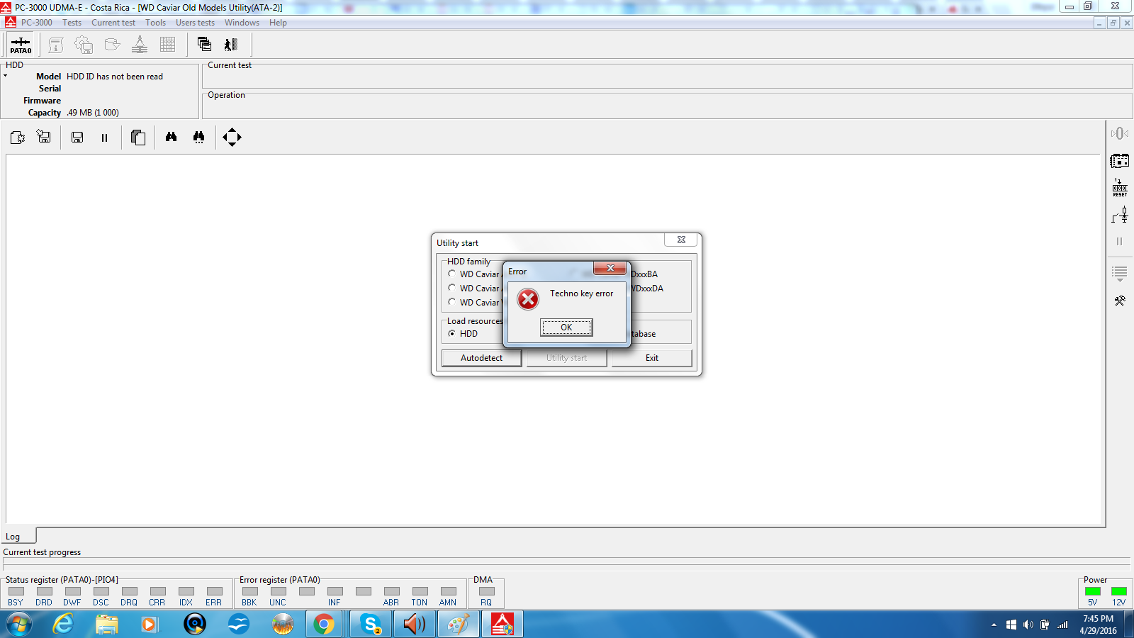

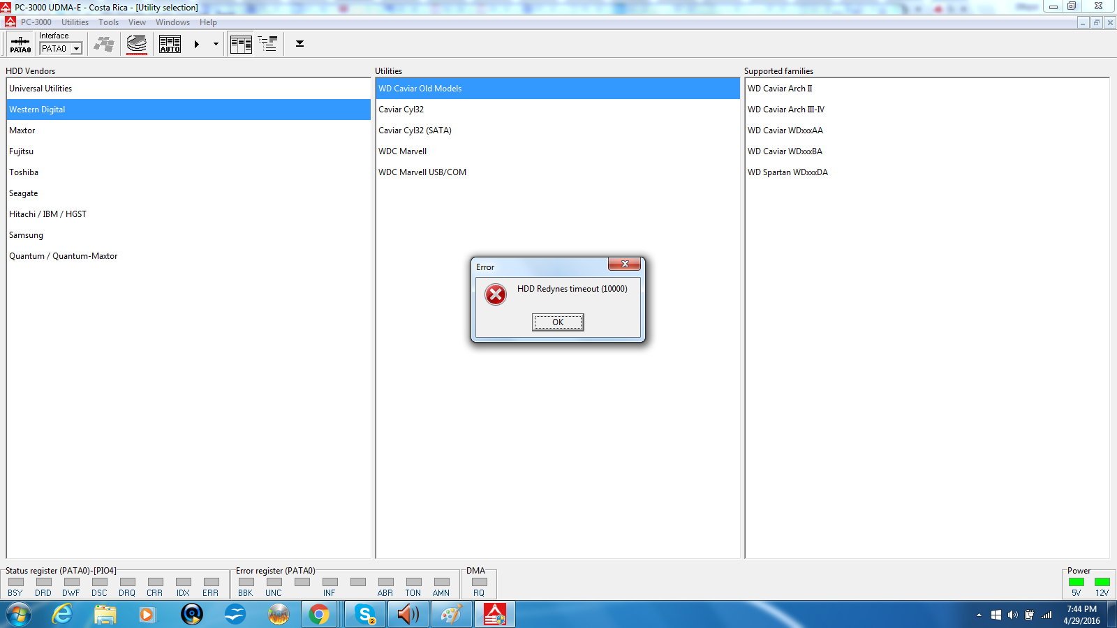

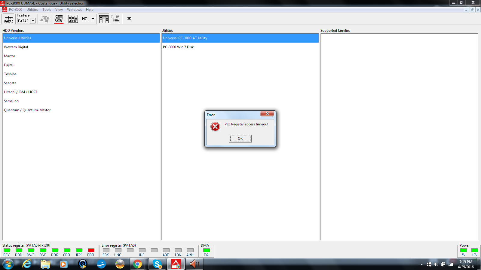

Help... Need your guidance.
HDD western digital WD400- WD400BB-75EA0
Start spinning and HDD is making high trebele sound.
I am getting this error as soon as I run autodetect or run utility.
Error:
1. PIO Register Access TimeOut
2. HDD Readyness Timeout (10000)
3. Techno key error
Attached pictures.
Thank you for the guidance.

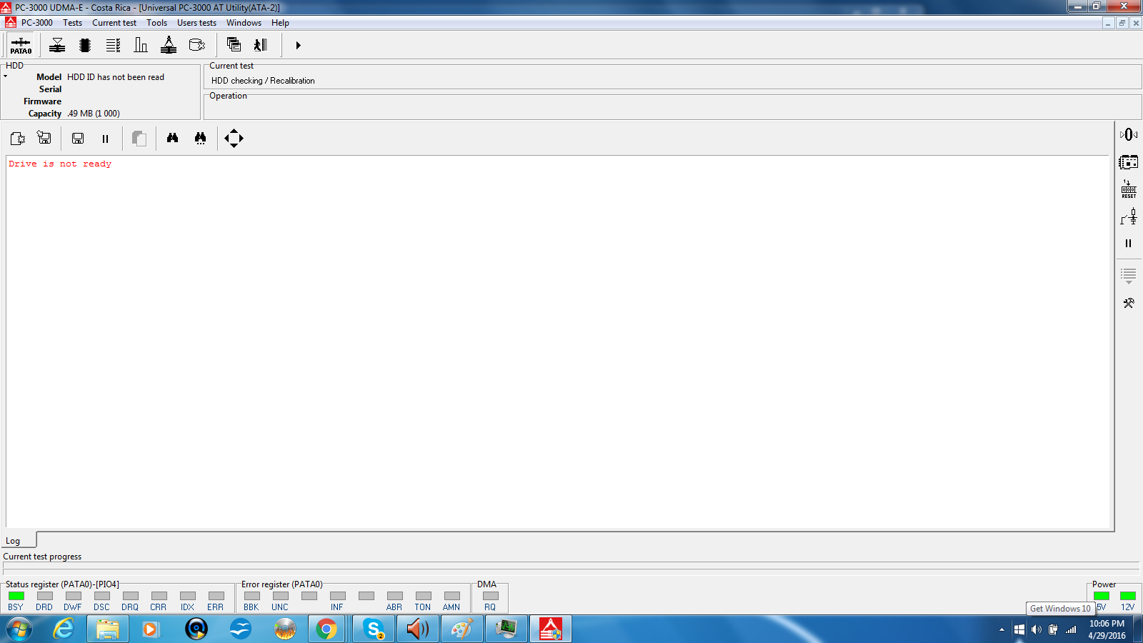

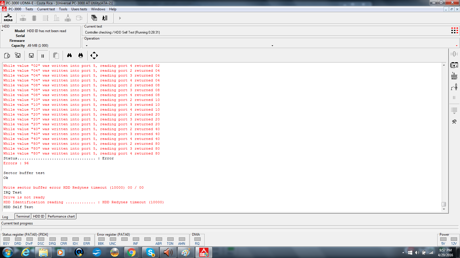

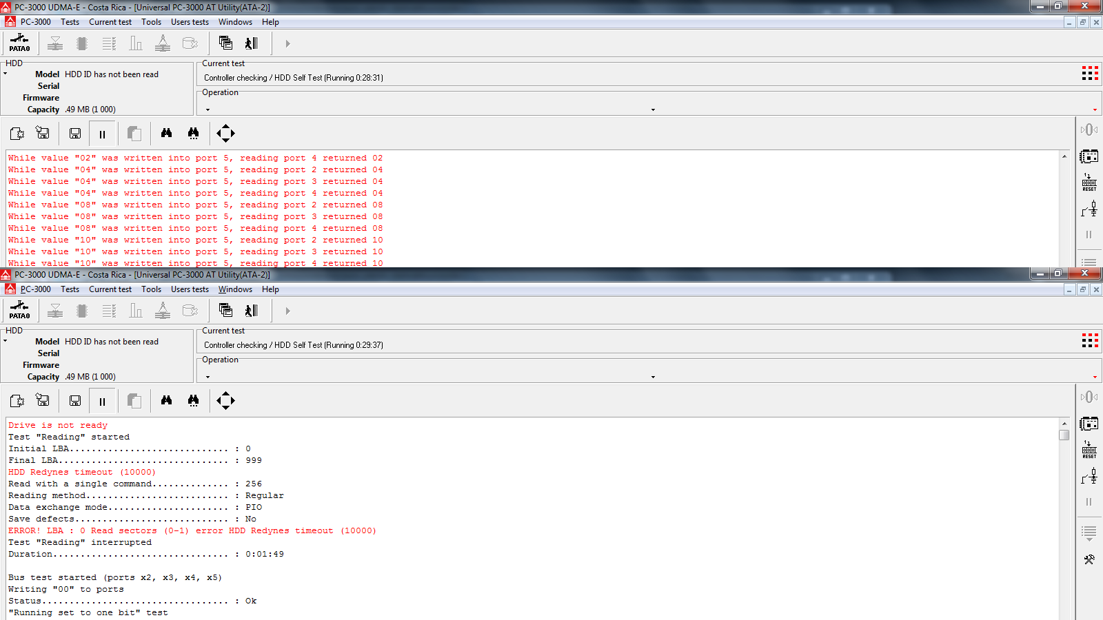

 Post subject: Re: Help!!! WD400- WD400BB-75EA0 - PC3K can not access it ye
PostPosted: April 30th, 2016, 0:23
Joined: March 3rd, 2016, 12:51
Posts: 49
Location: Costa Rica
It is showing Drive is not ready and did a research on forum and people is saying it might be translator issue ending in PCB problem.
Since is not accessible yet as it is I can not do some tips AceLab suggested.
some pictures attached of errors
PostPosted: April 30th, 2016, 3:38
Posts: 3551
Have you put the jumper in place?
Instead of drd dsc all registers will flash as per your 3rd pic, if you didn't.
Also why are you trying to SS the drive? :o
PostPosted: April 30th, 2016, 5:28
Joined: June 30th, 2008, 5:40
Posts: 64
make sure jumper settings on the hard drive is master

You guys rock.
I was able to put the jumpers and able to recovered the data.
You guys rock again.
Thank you a lot for your time.
