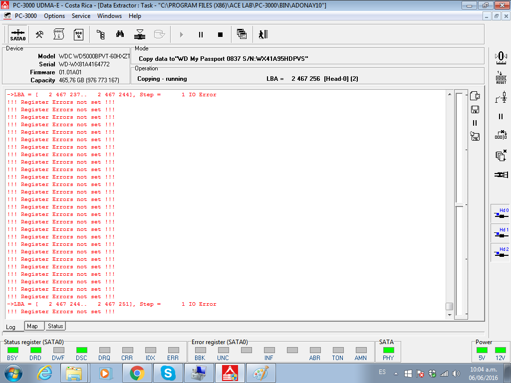

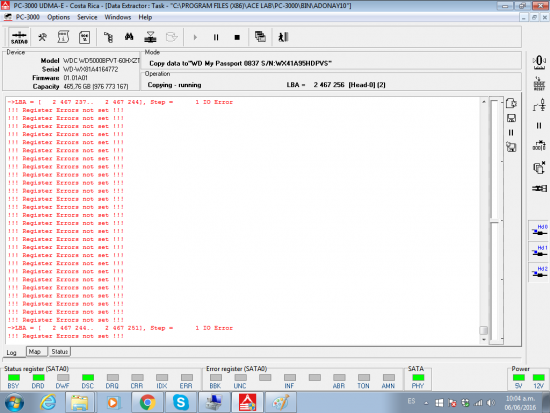

I am getting this message over the log: Register Error Not Set!!! and it is looking as bad sectors since it is showing black.
It was giving system errors the HDD in the lap top but I do not understand how got so damaged but I am wondering I can do something to save something, currently is running to see if I can recover something but it is going very slow since most of it looks damaged.

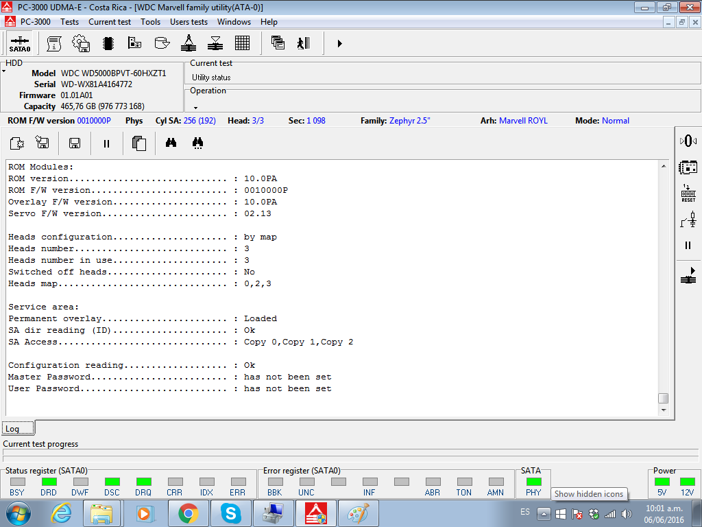

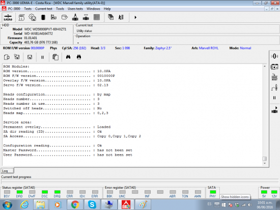

attached pic showing status on utility o Data Extractor

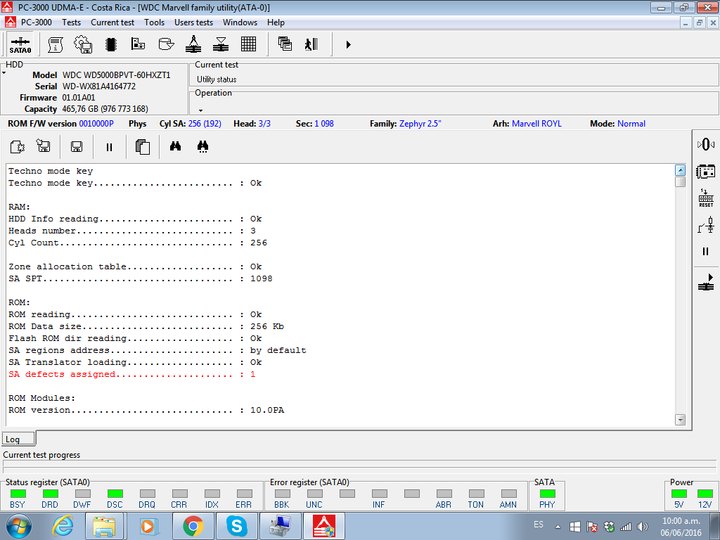

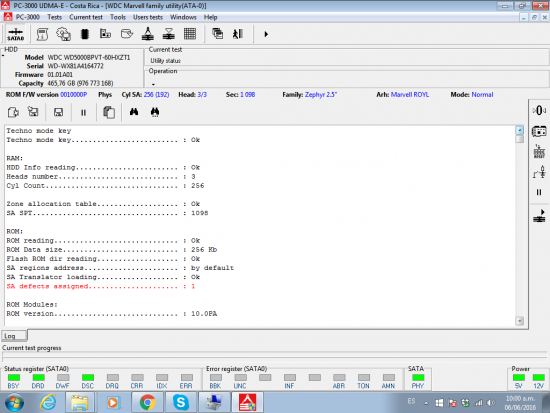

this is how is looking on the logs

Looks like some of the issues was the destination drive, PC3000 and windows talking each other... destination drive was online and looks like Windows was stopping from talking PC3000 with destination drive...
Great!!! "pcimage" helped me for free... Thanks for the teaching lessons... I am just starting learning on this and I appreciate the time as I know he was pretty busy and hungry, and he took the time to help me...
