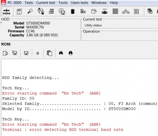

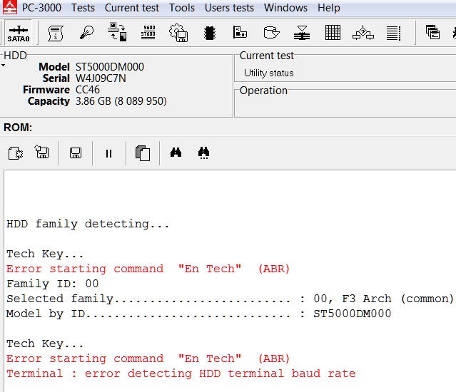

Just to add, we received one of these today. It spins up, clicks a couple or three times, powers
down and shows Ready in PC3K. When you enter the utility, it shows Model, serial number, but
only 3.86GB capacity. (see attached)
We opened this in our clean room and reveals Very slight marks at the front leading edge of
the top platter. So, an impact is evident, but no major scratches are seen.
Looking for a good donor (for heads) now...
-PP
