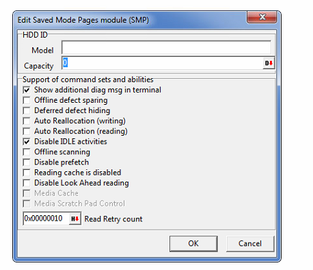

With terminal connected in Seagate F3 utility:
Tools > Utility Extensions > Service Information Objects
System File Tab
Volume: 0x03
File ID: 0x0093
Copy: 0x00
Click OK
Click second last button under ROM menu that has paper icon with little 'i' on it, click the drop down arrow and then select 'Edit Saved Mode Pages module (SMP)'
Should look something like this below, write changes to HDD and restart it.

Nick_CT thanks very much, works very well, I am very grateful
