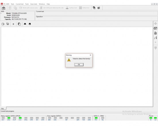

I have Toshiba 500 GB DT01ACA050 Sata 3.5 inch hdd. In which family hdd will work.
Any help appreciated......

hdd failed to detect family.....showing all information correctly.....
Which one is it ?
Or

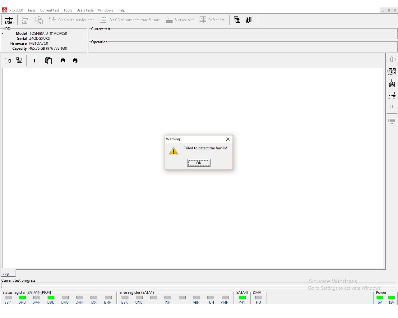

hdd failed to detect family....and in top left corner in toshiba utility showing size, s/n, fw......

Oh, it won't be the detected automatically
Choose manually 7210DLE6 from the ARM utility

This is only remarked as Toshiba, actually is Hitachi ARM drive.

Try Both Families 7230ALA6 or 7210DLE6 , one of them will work ....
if fail try again with the Tech Keay detection option... :D

The PCB P/N of the DT01ACA050 is 0A90381. A Google search suggests that Hitachi models which use this PCB include HDS721010DLE630 and HDS721050DLE630.
The HDS723030ALA640 uses a PCB P/N 0A90284.
